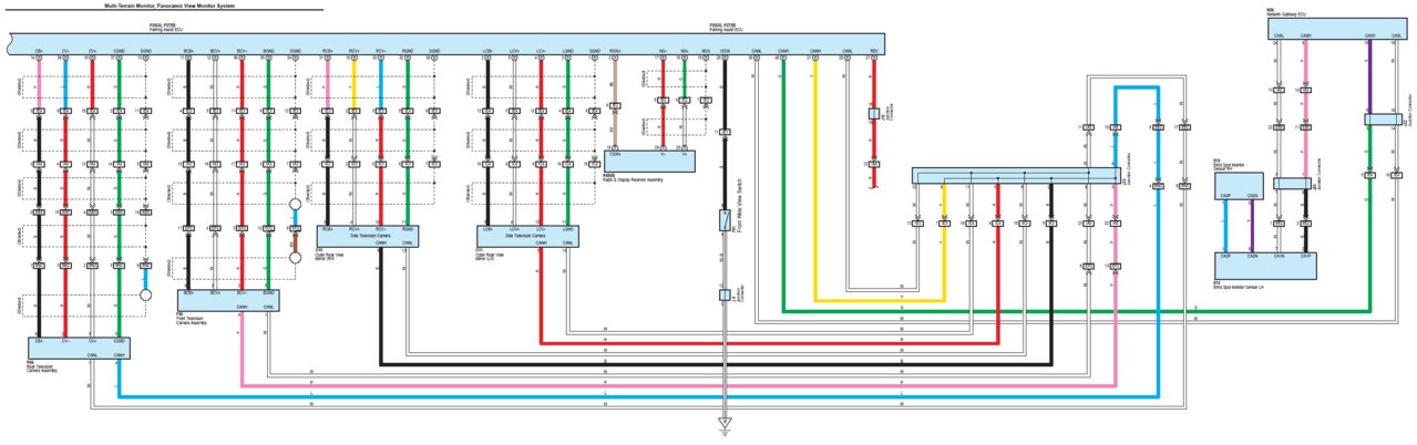

    That was me .. so here it is Post #1090
    I was using my finger on my tablet so it's a little crude

    That's gonna be a pipe dream, the 2020's panoramic cams are all tied into the CanBus to do their thing...:annoyed:
    Just kidding...it might be a doable thing.
    Reverse interrupt and Front view select switch...

    Do you have a higher res pic?

    It's just MSPaint...copy, edit and paste...but knowing what goes where and why helps too...:burp:

    I do...but you'll have to stitch it...

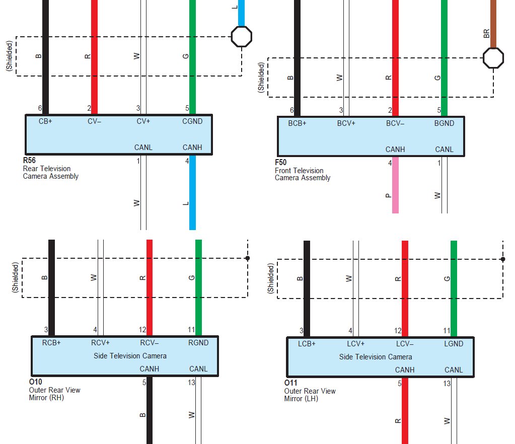

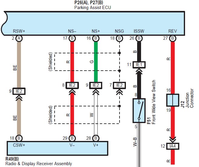

    The only switch I see is the "Front wide view switch", although the left front panel switch has four wires going to it. Is the backlighting wiring not shown in this view? Assuming this is the switch, it looks I can just tie the black and grey wires into my stealth switch.
