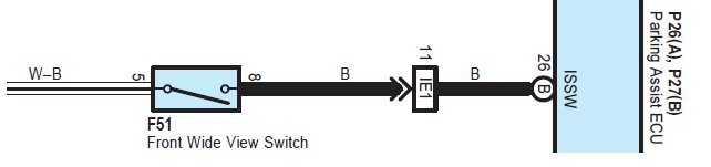

    Wow this looks promising. If Just a pull down to ground through the switch... could work the same on the stealth knob

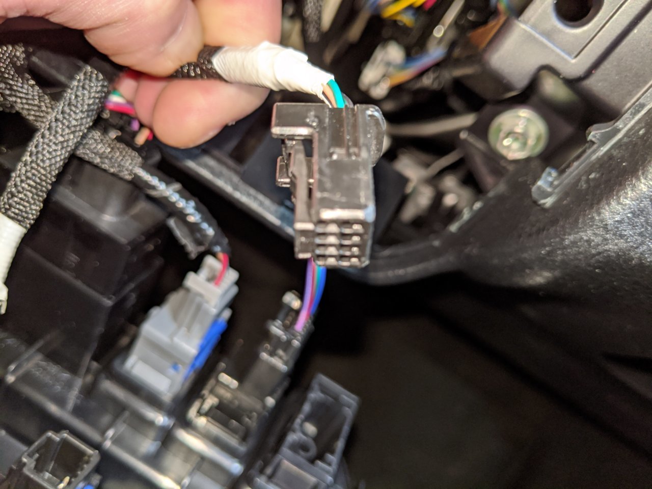

    Connector to Front Wide View Switch:
    Look familiar? @MESO

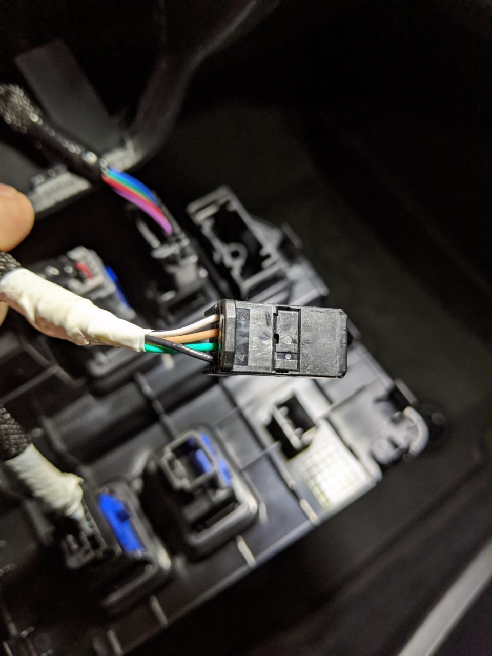

    Here's the plug off the switch
    Another view
    I believe I can tie the black and white wires into the second switch on the shifter. Hopefully I have the splices I need, most of my wire repair stuff is on my boat, which is shrink-wrapped for winter. Always something.

    Nice.. only 4 wires. I’d bet the two outside once touched together will trigger the multi camera mode. The 2 middle wires are illumination + and -.

    CONFIRMED!!!
    (Mr. Paperclip to the rescue)
    Jumped the two outer pins (5 & 8) and the front camera view came up:
    (Please excuse my messy garage)
    The OEM switch is a momentary, so just touching the pins brought up the camera. A second jump cycles to the second view, third jump brings it back to the home screen. This is how the OEM switch works. Success! Now I need to round up the wire and splices I need to finish the job. Thanks so much guys!
