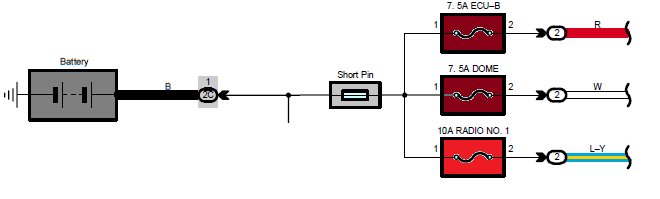

    So the battery on my 08 4L was dead again... and so I got fed up of buying new batteries for it. So with a bran new batterie I pulled fuses to see what was pulling the power( with the key out of the truck and doors shut) turns out the ECU-b was pulling .50 amps all the time.
    Now the other problem . The truck cranks but no start.

    So the Body ECU is drawing a half of an amp or 500 milli amps.
    If that is true you have a problem.
    ECU B supplies these functions:
    ABS (w/ VSC), TRAC, VSC, Auto LSD, Downhill Assist Control and Hill–Start Assist Control
    Accessory Meter
    Air Conditioning
    Combination Meter
    Cruise Control (1GR–FE)
    Cruise Control (2TR–FE)
    Door Lock Control
    Electronically Controlled Transmission and A/T Indicator (1GR–FE)
    Electronically Controlled Transmission and A/T Indicator (2TR–FE)
    Engine Control (1GR–FE)
    Engine Control (2TR–FE)
    Engine Immobiliser System (1GR–FE)
    Engine Immobiliser System (2TR–FE)
    Headlight
    Interior Light
    Key Reminder
    Light Auto Turn Off System
    Multi Mode 4WD and Rear Differential Lock
    Power Outlet (115V)
    Power Window
    Rear Differential Lock (2WD)
    SRS
    Tire Pressure Warning System
    Wireless Door Lock Control

    It's an ALWAYS ON fuse/circuit. Nothing to check.
