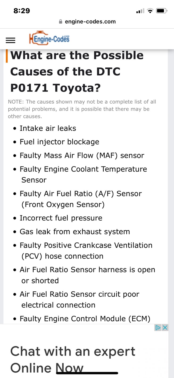

    I know u said P0171 on b4 deer and engine removal
    But a good list of things to start with
