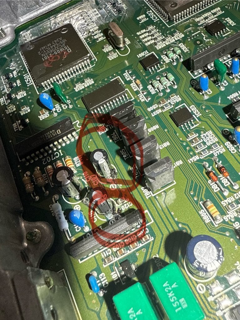

    Been having some trouble with the CEL intermittently going in and out. Today it came on while I was at a light idling and then shut off. Already tried to have it diagnosed at a local mechanic. They couldn’t read from the OBD and the light went off while they had it. When the light is on it seems like it’s in a limp mode and shutters a lot when initially giving it gas. The OBD port does work when the light is not on but when it’s on I can’t seem to get a read. Mechanic had the same trouble and said they tried three different scanners. Full tune up recently, cleaned the MAF everything seems to be okay. I same a couple other posts mentioning the ECU, so I went ahead and pulled that. Looks like two of the capacitors have some corrosion. Anyone ever replace any of these components in the ECU? Is it worth it or should I just try to pull a new one from the junkyard?

    Capacitors fail, it's not an uncommon problem in the electronics world especially for 30 year old vehicles. Match up the caps on a reputable site like Mouser.com Digikey.com, don't buy them on Amazon or the like, and learn to solder or find someone that can.

    As already said Caps are known to fail. I have seen it many times in main boards. It’s usually age related.

    Appreciate all the help. I ended up sending it out to SIA electronics. I don’t trust myself with soldering. I’ve seen mixed reviews so I’ll update when they send it back.
