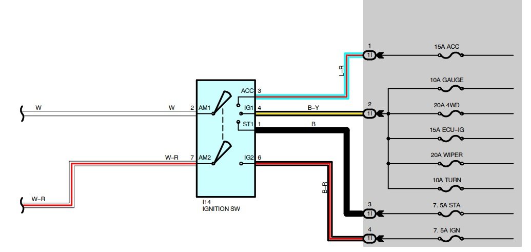

    If that's good (I'm assuming your powering up the IGN Fuse 7.5A?) then you need to go the the ignition switch and check for power in on Pin 7 (White/Red) and out (with the key in the run position) on Pin 6 (Black/Red).

    Just wondering. If it works with switch from battery to inside fuse box ignition fuse .does that mean a short some where between battery and that ignition fuse

    I'm thinking failed ignition switch, that's why I wanted you to check power in and out of the switch as that's where the IGN fuse get's it's power from.

    OMG Glamisman/DM
    Excellent diagrams !!!!!
    I have to ask
    do y’all have access to same diagrams for 96 2.4L? Xtra C/2wd
