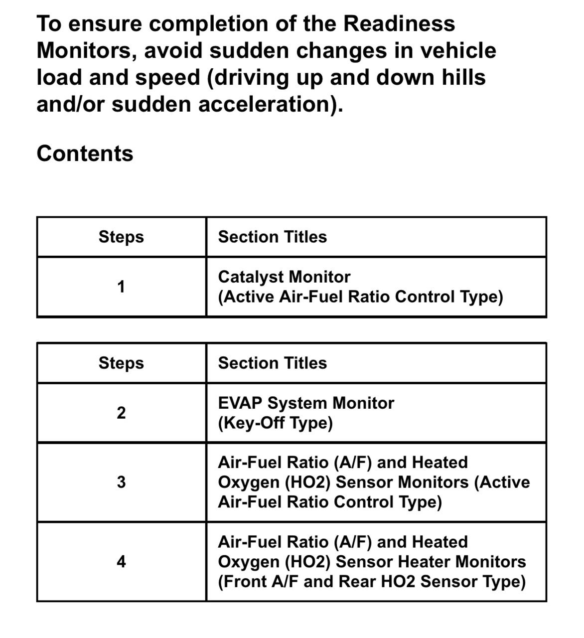

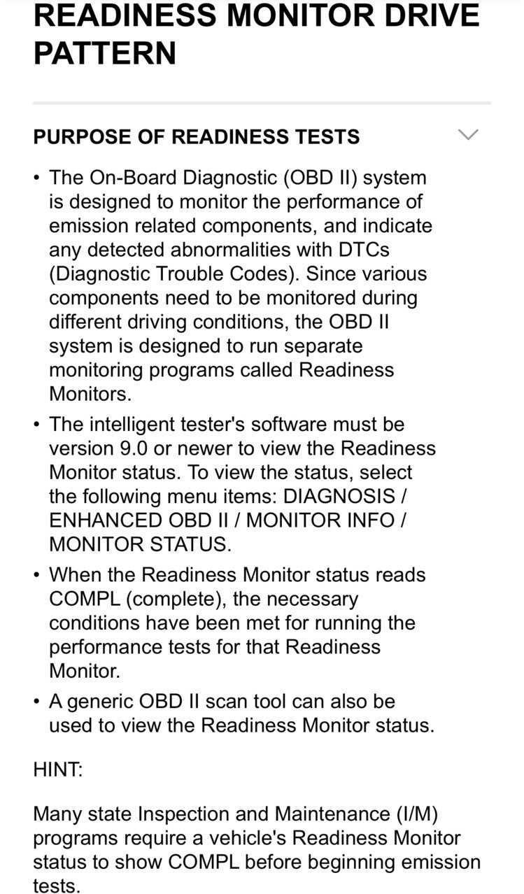

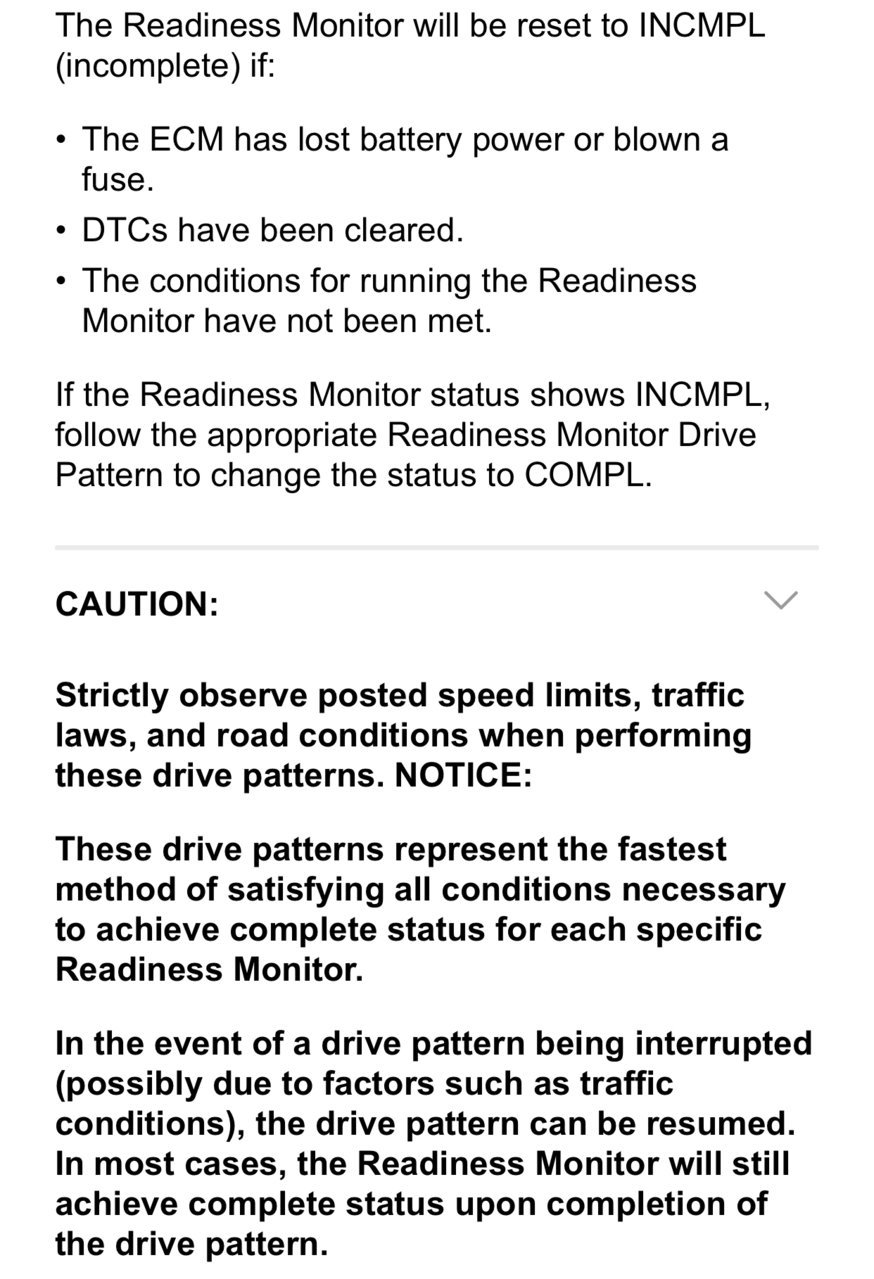

    I recently had to replace the positive terminal on my Truck, Did not touch the negative terminal, truck runs, fine no codes. went to get smog and the guy said, I did not install properly and need to follow manufacture procedure on Your year and model? I cannot find in the owner manual or service manual what he is talking about? Does anyone know?

    There is a time period to do the readiness monitors test. You must drive and wait for them to be complete before doing any vehicle inspections.
    below are the 4 tests it will run and need to be complete to pass in smog states.
