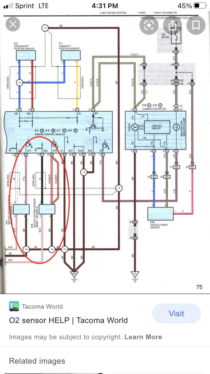

    My replacement ECU is still stating the “coolant temp insufficient for closed loop operation” my scanner sees it rise from cold to 185. I hate to just buy another sensor considering I can read it. Here’s the drawing. What would you look for? All grounds are fine. E0885071-C17B-4219-8E2B-99AAD910F035.jpg

    I looked at a few wiring diagrams and they all show the same thing... part of the circuit for the ECT goes through the TPS. It sure sounds like the signal from the ECT is not getting to the PCM. I would disconnect all the connectors on that circuit and check for continuity, opens and shorts on the 2 wires that feed the ECT. As a final check follow the wire to the PCM and remove just that connector and see if the pin is bent. You might get lucky and by just reattaching the connector "fix" the problem.

    You are absolutely correct. After spending six hrs looking at this, I discovered the shielded conductor in the four conductor front O2 harness had chaffed the top of the transmission shorting the grounded shield to the conductor within. Had to worm the harness out towards the drivers side to fix it. Thanks to who ever posted those links for the 2000 engine harness…. I was unaware anything was shielded till I saw the drawing. I assumed incorrectly that my scanner was being honest with me. Runs awesome now. Thanks
