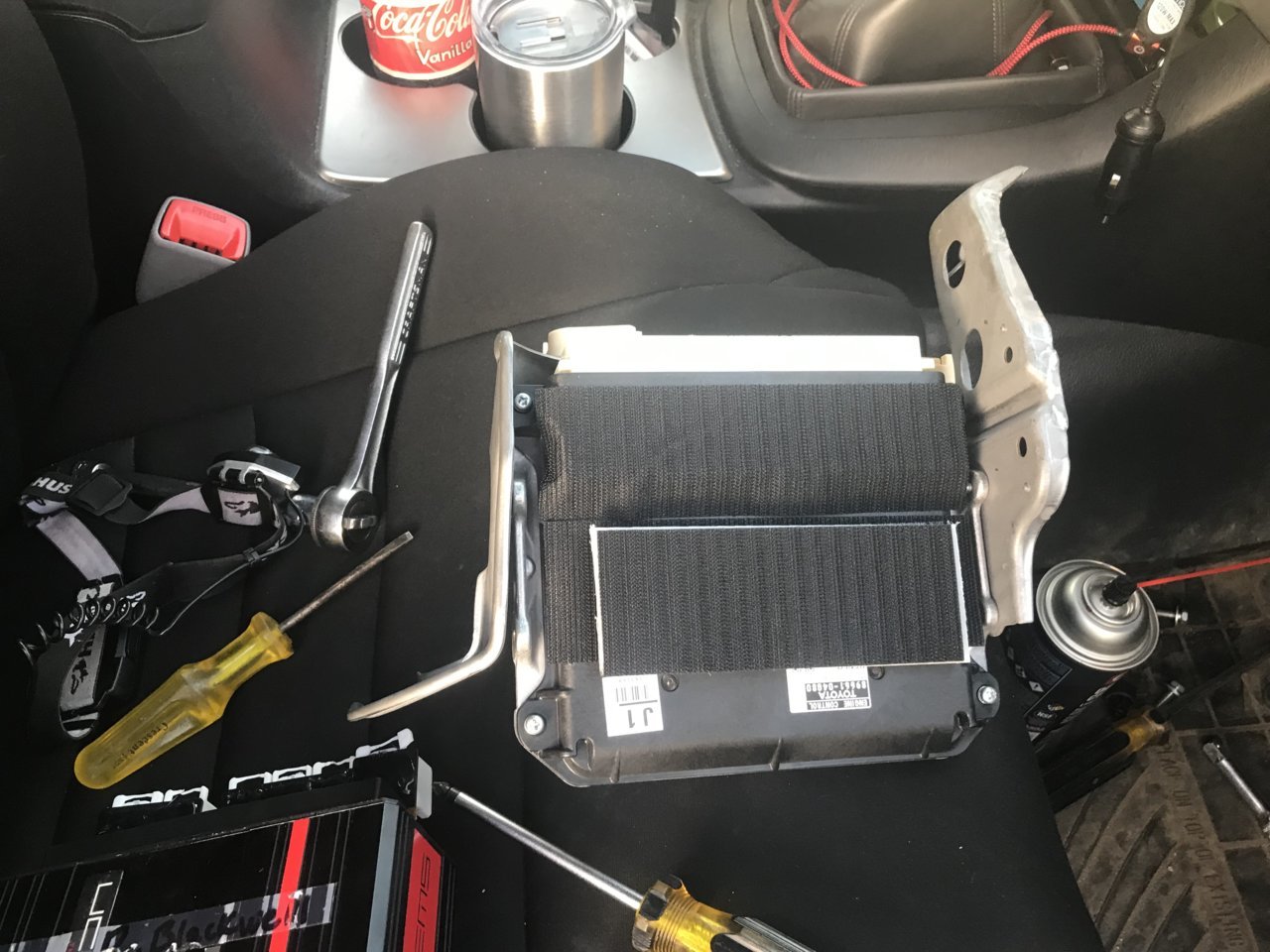

    It is behind the glove box on the right side. To remove the glove box, open it up, and squeeze inwards on the two piece on the side. That will allow it to drop down further and then you can pull it out completely. Once youve got taht out, unplug the ECU and immobilizer, and remove the ECU. There are two 10mm nuts and a 10mm bolt (so 3 total) and then you can finagle it out of there.
    Here is what the ECU will look like when you have it out. I have velcro on mine only because it is there to stick to the UCon. Let me know if you have any questions or trouble

    I can get you some more pics of what youre gonna be looking at when i get off work here in a few hrs if youd like, just lmk
