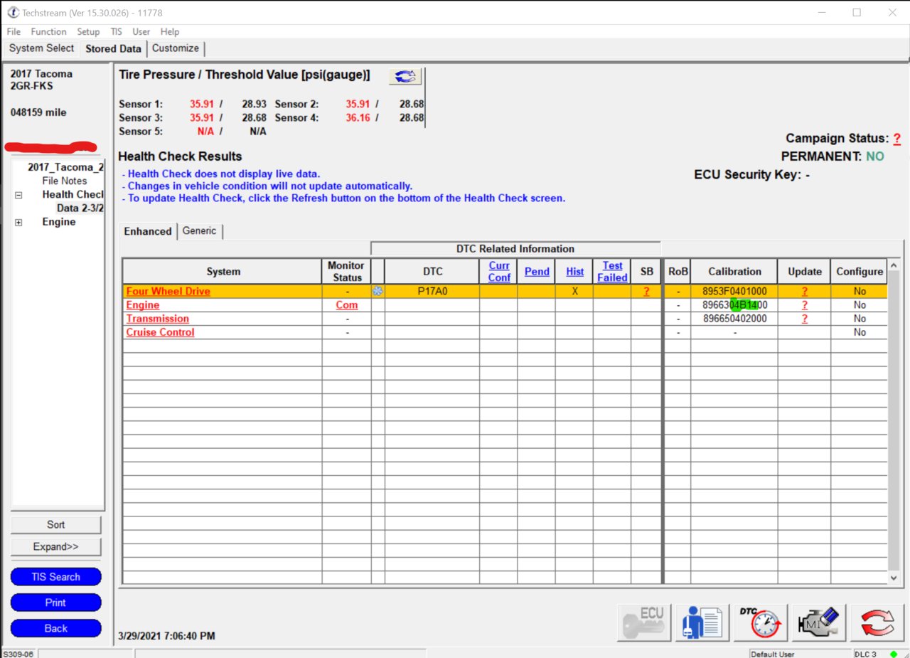

    Note! Flashing a TSB has a chance of soft bricking your ECU. It is very important to follow the instructions and flashing tips below, esp the prompts in TechStream, to the letter. You have been warned. An ECU can be recovered, but it will not be fun.
    @Ruggybuggy did us a major solid finding the original MT ECU updates in the AT TSB TSB-0058-18 and starting this thread. He has moved on to the Tundra. I am updating the text for this post as this train has not stopped rolling. Toyota and Service Advisors have been generally difficult to get this TSBs applied for both ATs and MTs. So, this thread is the guide for updating your ECU at home.
    From @Ruggybuggy :

    Before connecting to the Taco, plug the Tactrix cable into your computer to verify that the drivers recognize the cable. Open TS to test drive the program and pick the Tactrix connection from the drop down menu.

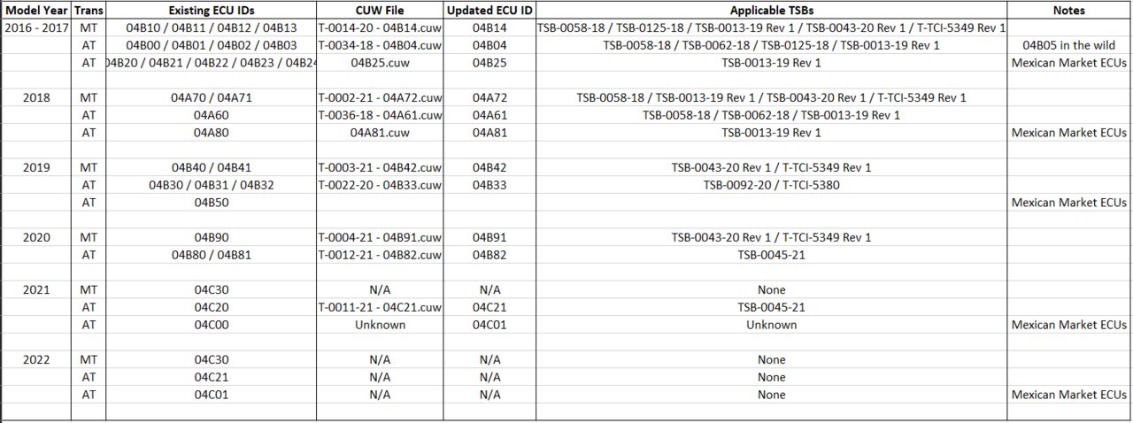

    Attached are the CUW files for both MTs and ATs. @dilbert put together this excellent spreadsheet to simplify things. Thanks!
    From the attached CUW files, place the one that is needed for your Taco on the computer desktop.

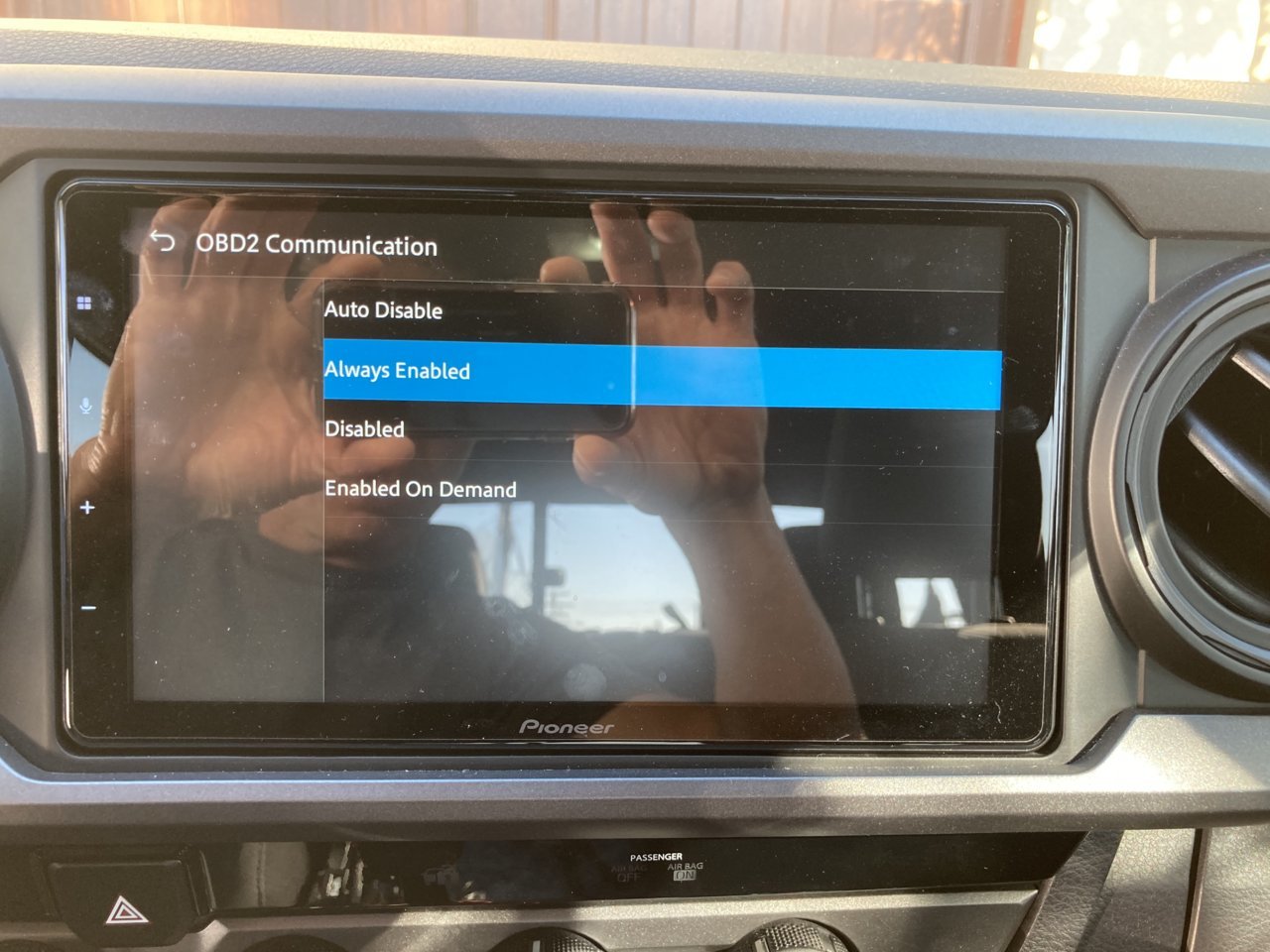

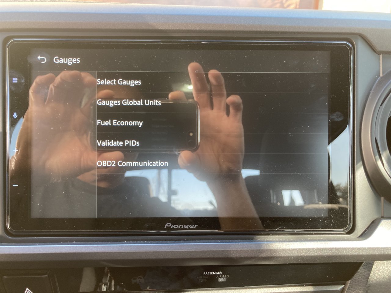

    If you have an aftermarket head unit and maestro interface you may need to disable ODB communication in the head unit before using TechStream to connect to vehicle.
    man these are awful photos. Let me try again tonight when glare won’t be an issue.
    Credit: @daveeasa
    IMPORTANT - Use this Checklist for Flashing. As best as you can:
    :anonymous: Do not use hacked versions of TechStream for an ECU update.
    :thumbsup: Do not use a virtual machine environment to do an ECU update.
    :thumbsup: Do not use Bluetooth or WiFi dongles for an ECU update (USB only).
    The Tactrix is a proven option. Other USB adapters (cheap chinesium ones) are not proven. A few folks have bricked their ECUs using them.​
    :thumbsup: Turn off Windows Update service.
    :thumbsup: Turn off Windows system sleep functionality.
    Use the “always on” setting in power management pane.​
    :thumbsup: Turn off USB Power Management for the USB port you are using.
    :thumbsup: Plug the laptop into a wall outlet.
    :thumbsup: Set the computer on the seat and do not touch it while it flashes! A bump or loose USB port could be a bad day.
    :thumbsup: Hook up a battery maintainer to the vehicle during an ECU update.
    :thumbsup: Turn off all electrical consumers during ECU update.
    :thumbsup: Open the hood.

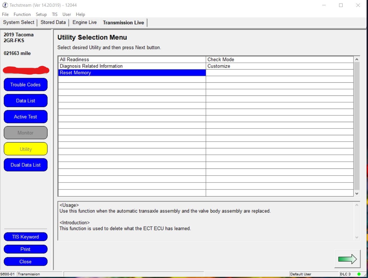

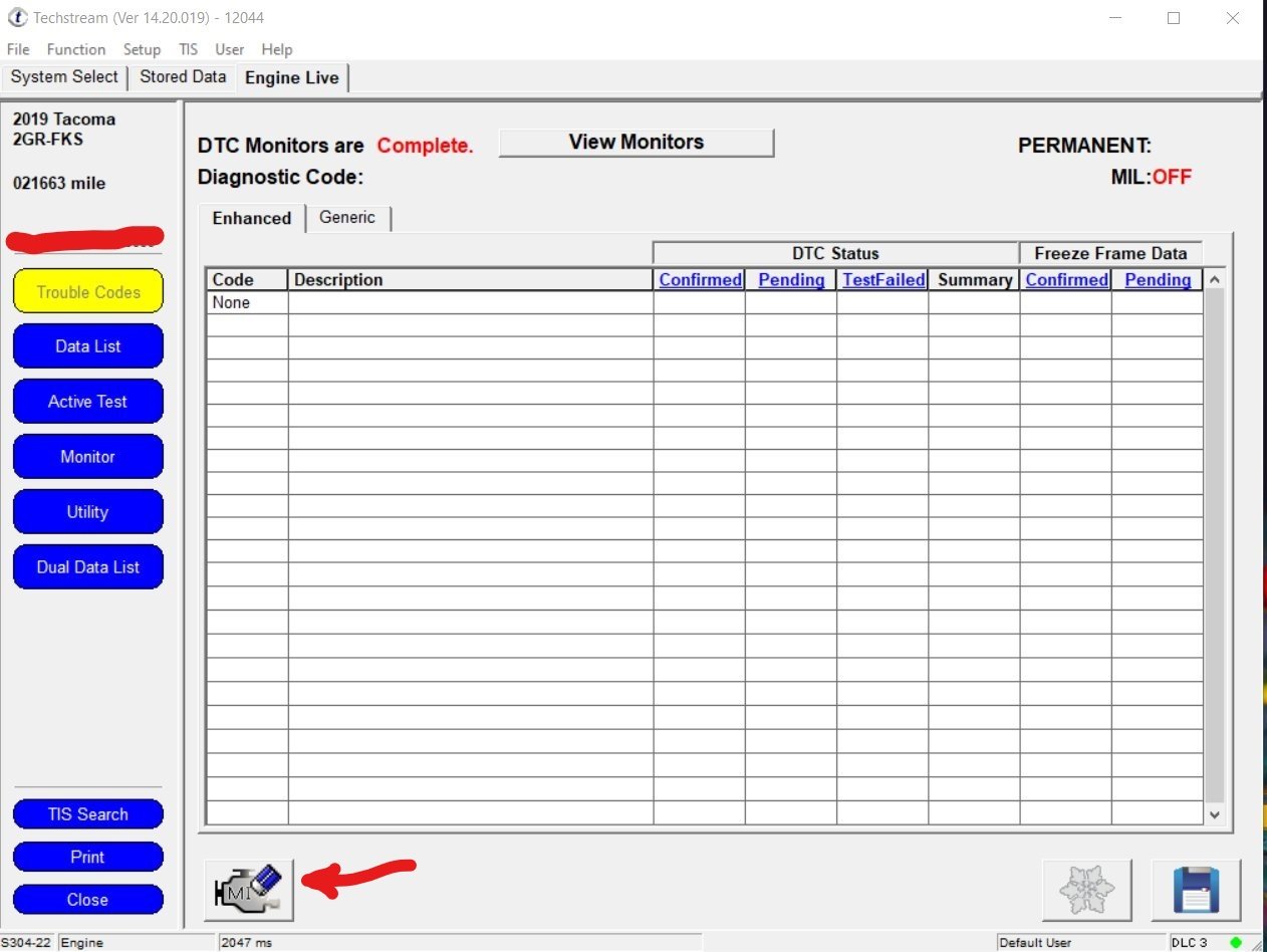

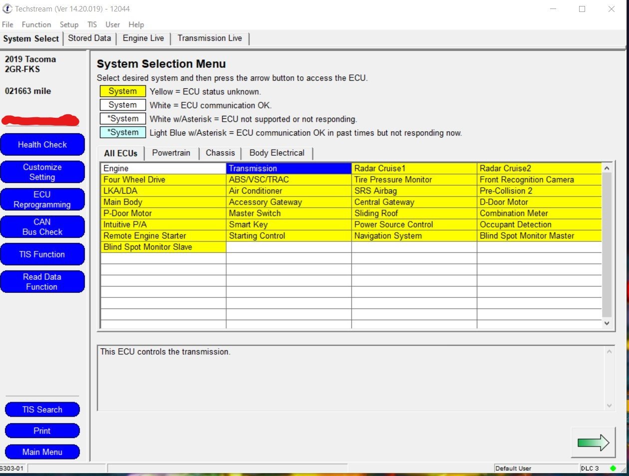

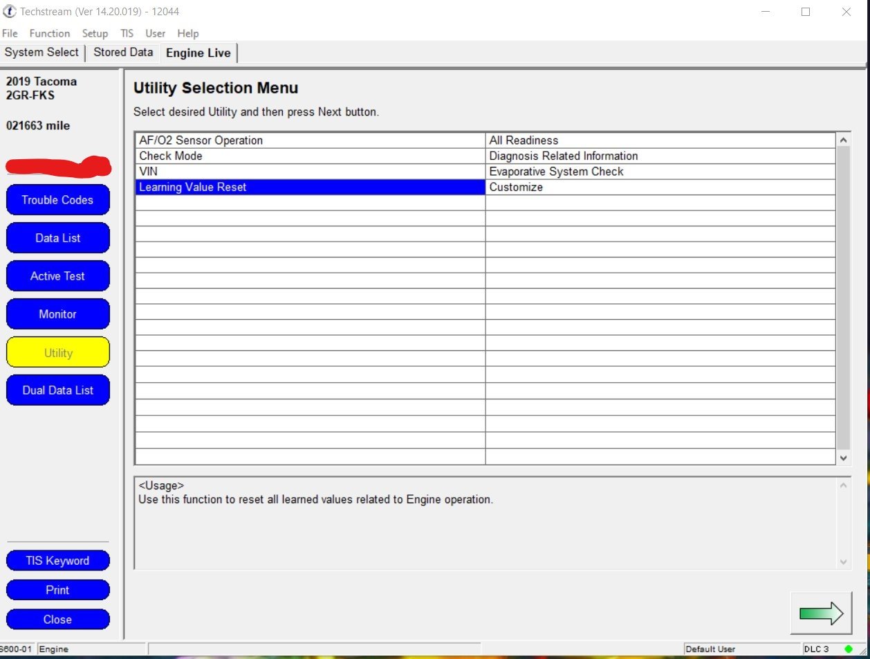

    It is recommended to Reset the DTCs, Learned Values, and the AT after you flash. MTs do not have the AT to reset. :D So, after the ECU flash:
    -- Start the motor briefly to test.
    -- Shut the motor off and then turn the ignition back to On without the starting the motor.
    -- Launch TS, connect, and find the Reset functions.
    -- Hit the DTC Reset, the Learned Value (LV) Reset, and the AT Reset, if you got one.
    DTC Reset:
    LV Reset:
    AT Reset:

    ** TS V14 Installation Instructions (credit: @Shellshock )
    Here's step by step setup instructions to setup TechStream V14. @Shellshock just did this using the download link from above on a clean state machine with nothing else installed so everything should be captured and documented. If you get a UAC pop up from windows, click Okay.
    1) Download V14 from above
    2) Click download
    3) Click download anyway
    4) Save the file
    5) Browse to the file download location (typically in your downloads folder)
    6) Right click and extract the files
    7) Browse to the extracted files
    8) Double click GTS_14.20.019_NDSI and click next
    9) Next
    10) Accept the terms. Next
    11) Put something in User / Company. Next.
    12) Install
    13) Finish
    14) You'll now see TechStream on your desktop. Double click TechStream
    15)
    16) Select North America. Next.
    17) Select English. Next.
    18)Fill in Dealer Name, Dealer Code, Dealer Phone. Click Ok
    19) Any time a Java pop up appears, Click No. It also appears when you launch TechStream.
    20) Copy the Software ID (highlight, Right click, Copy)
    21) Double click techstream-act.exe to run (found in the folder of extracted files, Step 7)
    22) Enter the number "2" for TechStream V14.20.019 (the version we have installed). Press Enter / Return Key
    23) This step is optional but will make the next few steps much easier. If you don't do this one, you will need to manually type out the Software ID and Activation key. I'm lazy and can't type, so I copy / paste.
    Goto the upper left corner of the window, right click, select properties. Check the box for quick edit mode. Press Okay
    24) Right click anywhere in the window. The key you copied earlier will paste. Press enter. The activation keys will appear. Select the "NA Activation Key" and right click. This will copy the key.
    25) Paste the key into TechStream and click Okay, not any of the other buttons.
    26) Techstream will now show 5000+ days remaining in the lower left
    27) In the top menu bar Click setup and VIM Select. Change the drop down to Openport 2.0. Click ok.
    If this does not appear as an option in the drop down, you need to install the Tactrix drivers and plug in the cable.
    ** If you get a forced TS Critical Update prompt when trying to Connect to Vehicle, turn off wifi and try again. The 30 use countdown will restart if you accidentally Connect to Vehicle on wifi again.
    28) At this point TechStream is fully configured and operational. You can click "connect to vehicle" in the upper left to complete any customizations (seat belt chimes, blinkers, etc).
    29) To apply a TSB, all you need to do is double click the CUW file and follow the on screen prompts.
