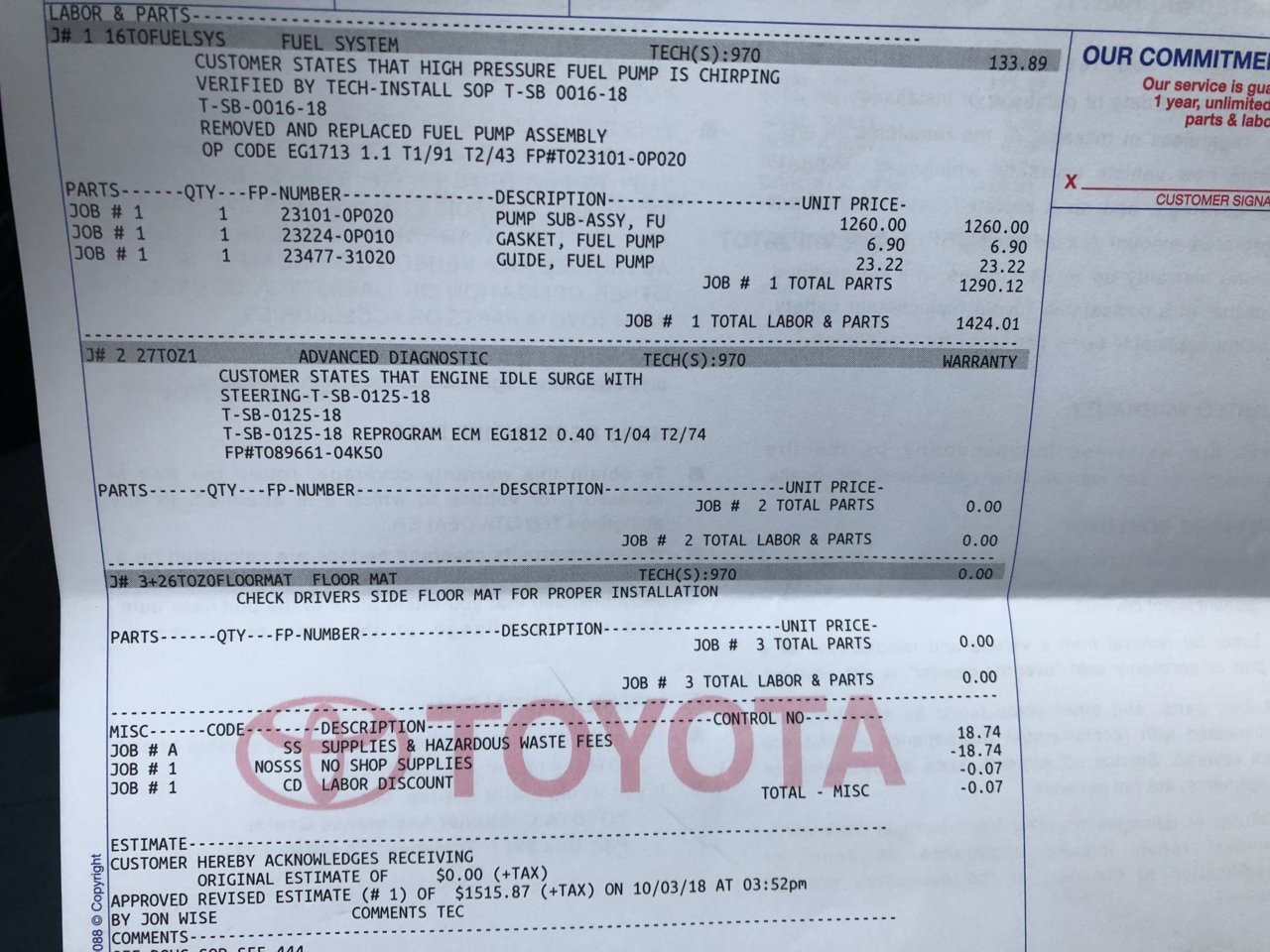

    TSB-0125-18

    do you have a print out explaining the fix? I cant find anything on the internet with that TSB Number

    I'll look for one, for now I can just tell you that it is for engine idle fluctuating when turning the steering wheel. The fix applies to all V6 engines and 6ATs and 6MTs. It has the 04B13 update in it and the corresponding file for 2018+ trucks too.

    Mine is a 17 MT-6, but I already have the update to 04B13 and it still does it.

    Seems like the new TSB is there to give the dealership a reason to flash MT trucks...lol. All vehicles surge when you turn the wheel, it's to power the power steering pump... lol

    I guess the the update only minimizes this. But I would agree with. Check page 99 post #1962 for the TSB .pdf@SContiVT , the power steering pump is leeching some engine power which is normal to some degree, and gives the dealer few reasons to not perform the new update.
    yes, makes sense. Can't argue with that.
