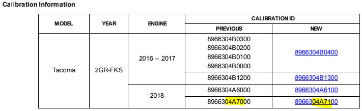

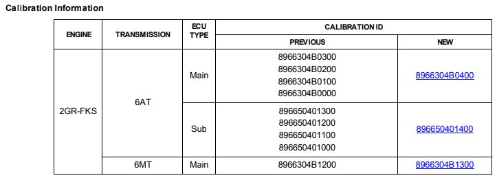

    Checked the calibration # on my 7/18 build date. I have not had the TSB done yet.
    A7000 is what it’s showing, I think the latest is A7001.
    What I’m wondering is are the numbers chronological? Would one assume the A7001 addresses the power steering surge (I think that’s the lastest TSB?). Engine surge, shift and MPG increase would have been a earlier calibration before a my build date.
    Hope that makes sense.
    Just trying to decide if I’m willing to potentially waste time at the dealership.
  14. Oct 9, 2018 at 8:47 AM
    #2074
    tonered
    tonered [OP] bartheloni
    Sep 25, 2017
    #231055
    31,334
    tony
    Lynnwood, WA
    From everything that was said and posted, TSB-0058-18 and TBS-0125-18 give the same end result. For your 2018, it is the highlighted text.
    From TSB-0058-18:
    From TSB-0125-18:
    For whatever strange reason, they did not cover the 2018s in TSB-0125-18, but taking both TSBs with you to the dealer and showing the correlation for the 2017s (04B12 to 04B13 in both TSBs) should help folks get a solid update. There is software for each model year up to what seems to be the August, 2018 builds.
    Similar for the AT folks, TSB-0058-18 and TSB-0062-18 have different descriptions but apparently load the same software for them.
