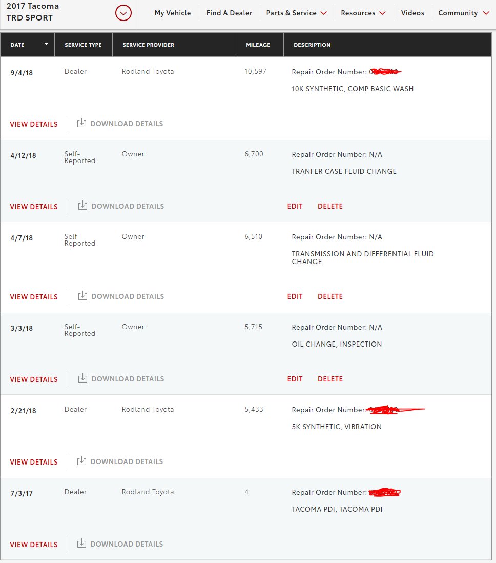

    Just to add to that, go to toyota.com, click on Owners. Sign up there and you can directly log all your work as owner maintenance:
    In each of the entries that I made, I added the brand and type of fluids as well as any part numbers for seals, gaskets, and filters.
    With those purchases all on Amazon, I have easy access to the receipts.
