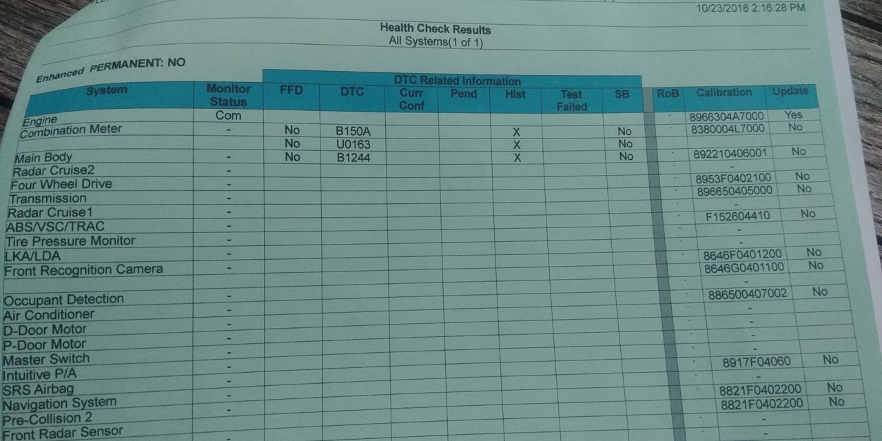

    Sorry, but 04A70 is the old tune (first row in your pic). You're looking for 04A71. So yeah, they lied to you.
    If you happen to borrow a cable, I'd be happy to help with the update.

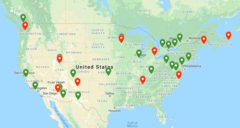

    UPDATE... so I have been going through the thread adding dealers that will, and dealers that won't, to the map. I am on page 90 now, and there was 58 posts with "Dealer did/didn't do it" but no dealer info listed :(
    If you've made such a post, please consider updating the map with the location and result. Do the search, and select the check box for the status, then select "add to map". You can change the color to red for bad, green for good, and press the pencil icon to edit the tag and add a comment linking to the post.

    Well, here you go! Green is dealers that will do it, and red is ones that won't.

    The dealer was Rudy Luther Toyota here in MN......it's marked as RED on that google map.....now that I was able to get it done, should we make it green? Yellow because it's hit or miss?

    basic GIS
    mmmmmmmmmmmmmmmmmmmmmm
    nicely made, will be adding mine in a bit
    jkcashin[QUOTED] and tonered[OP] like this.
