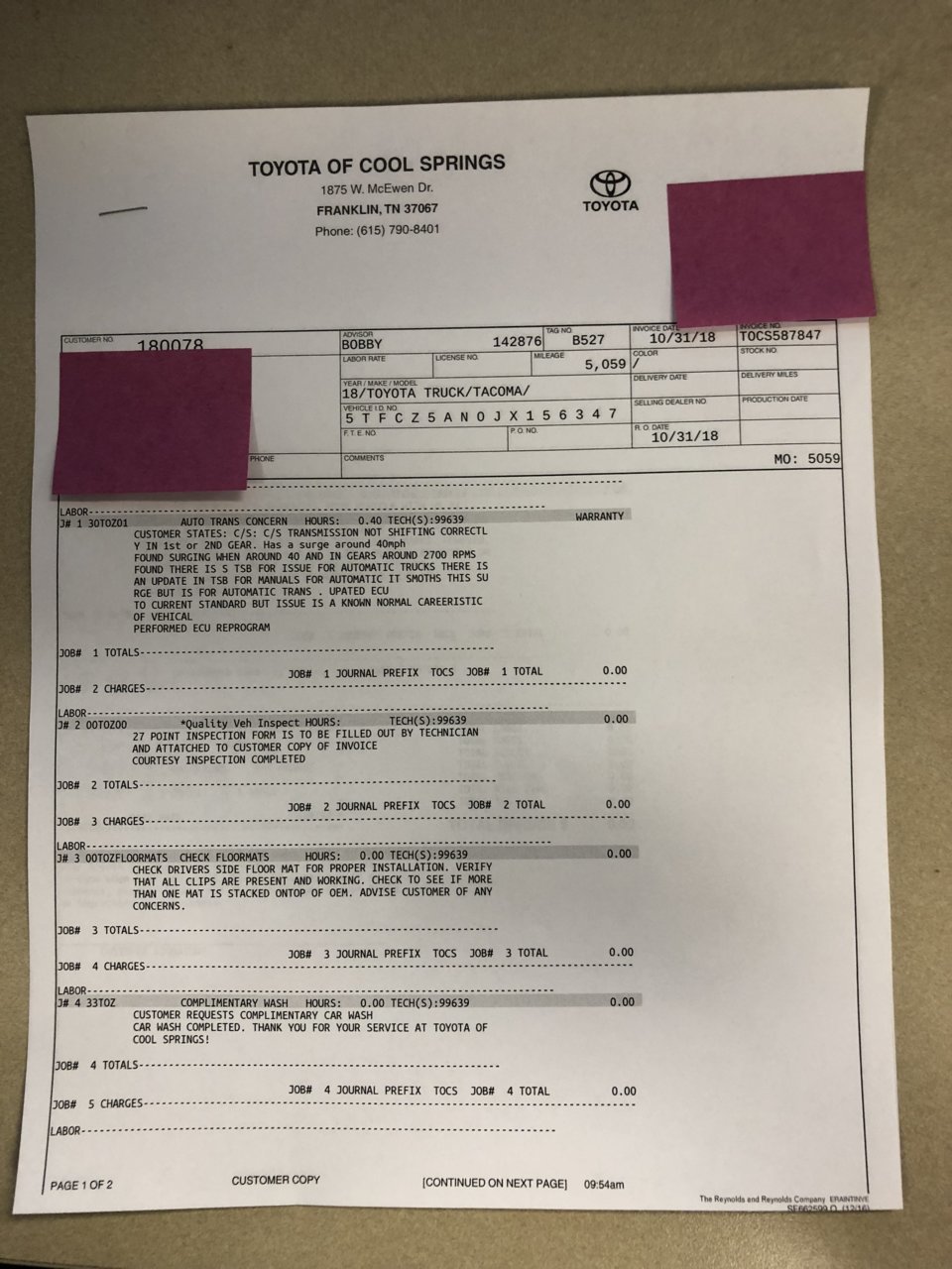

    tonered [OP] bartheloni
    Sep 25, 2017

    Finally got the update done. The service advisor knew about the TSB and said they'd take care of it no problem. It's definitely smoother and worth the hassle
