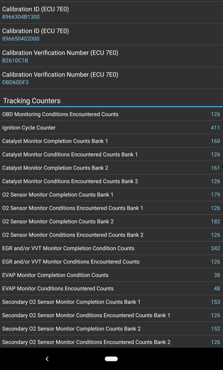

    Hey, Folks.
    I just gave the full version of OBD Fusion a quick test run.
    Here's my data dump:

    You'd have to use an OBD adapter and the OBD Fusion app. Otherwise, does it feel different?

    Mine is ancient and has worked flawlessly. About the only one that I can flat out recommend is the Carista one. The price without shipping is least on their website.
    I bought both the Fusion app and the enhanced PID at the same time. My guess is that you don't need the PIDs, but I don't know for sure. You can always add them on if needed?
    I'd probably wait to see how you appointment goes first? If you can get them to do any customizations at the same time and you see the calibration ID, you might not have to get an adapter unless you want to?
