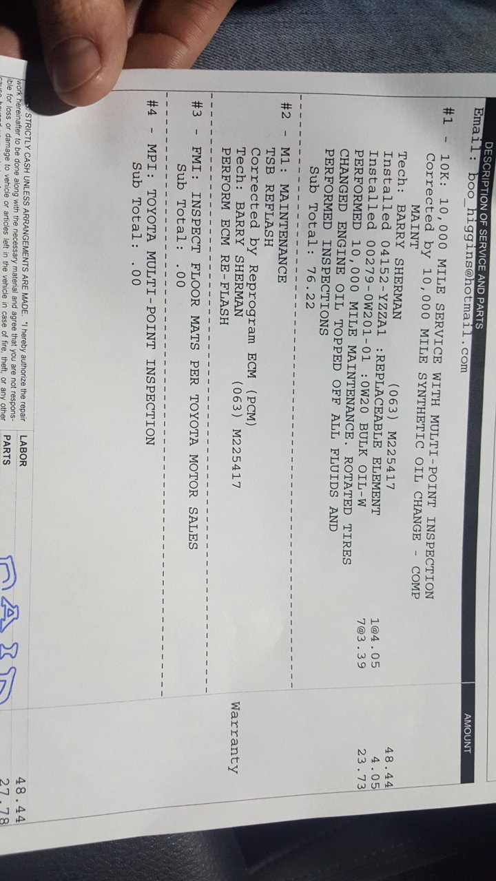

    https://www.tacomaworld.com/threads/software-update-for-the-manual.562550/page-114#post-19047596 was the link I had for the denial.... but I think we can mark it green now...
    What dealer, so I can update the map

    For a less than 10 minute flash. I hate that kind of response.
