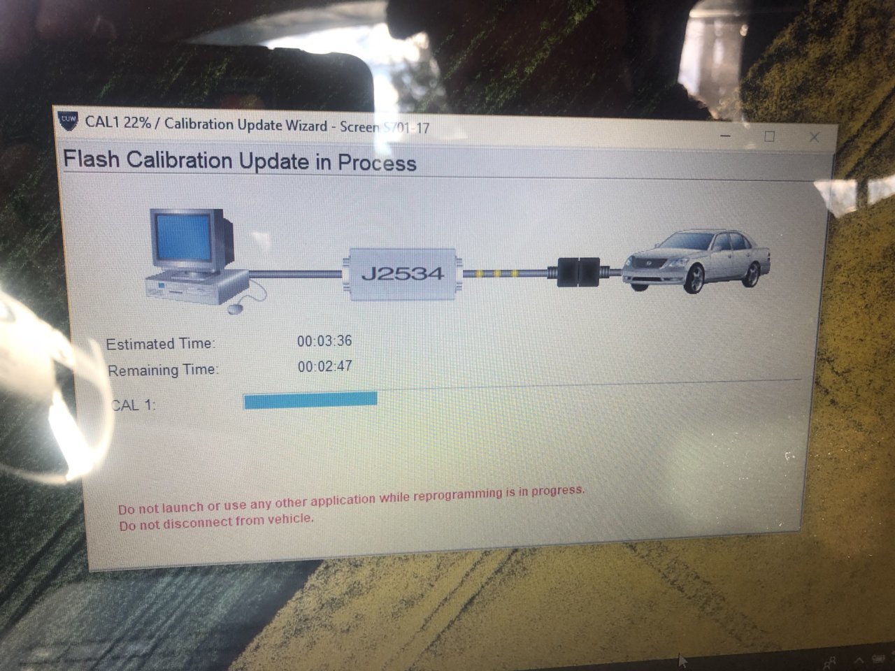

  8. Nov 8, 2018 at 8:26 AM
    #2348
    Livinserene
    Livinserene Thejerkyguy
    Nov 15, 2013
    #116646
    875
    Kevin
    Nova Scotia
    18 sport mt Ovtuned
    OV TUNED MOFOS
    78392870-B762-475E-975A-6949D74743FA.jpg All go
    all good friend thanks though ,, got it ,, after a 2 day subscription lol,, turns out my location etc was set for frickin Europe !! Lessons learned ,,
