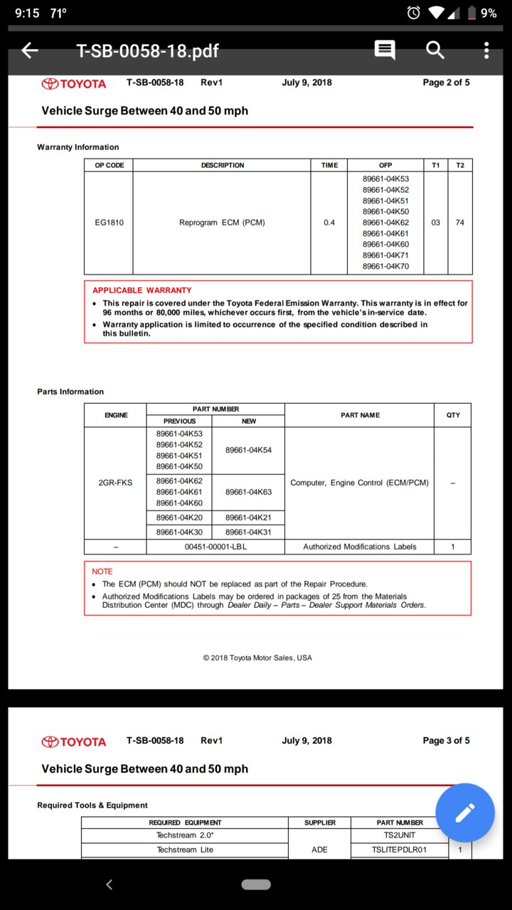

    It's going to be a month or so until I hit 10k, but I'll let you know how it goes at Rodland.
    Just curious, did you happen to point out the 04B12 ECU ID in the TSB?

    Are you beyond the powertrain warranty (80,000mi)? Take a look at the TSB:

    I showed them this whole thread including screen shots of all the pictures but because it doesn't specify MT they don't believe true.
    I'd be curious what rodland says...
    I'm dropping my truck off in a week or two when my lift shows up @ titus will where I purchased from. Those guys are tacoma nuts like us and would be hard pressed to believe there not already on top of this.
