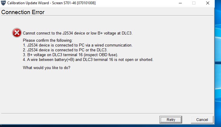

    I am trying to run the CUW file and when I do I get this error message. Has anyone else gotten this message? Any Ideas on how to fix it?

    1 and 2 are correct. Not sure what to do about 3 and 4.

    Modified the level of gas in the tank
    Hook up a battery tender, it won't go if it senses a low voltage. Punky battery perhaps. Known to happen

    I hooked up a battery tender and got the same error. I know the tactrix cable works because I just changed my OVTune from 87 to 91 1.04. Not sure what I am doing wrong.

    Did you make sure that TS is using the Taxtric cable to read? That is a setting that must be changed I believe

    That was it! Thanks @inksin. I was going crazy trying to figure it out.
