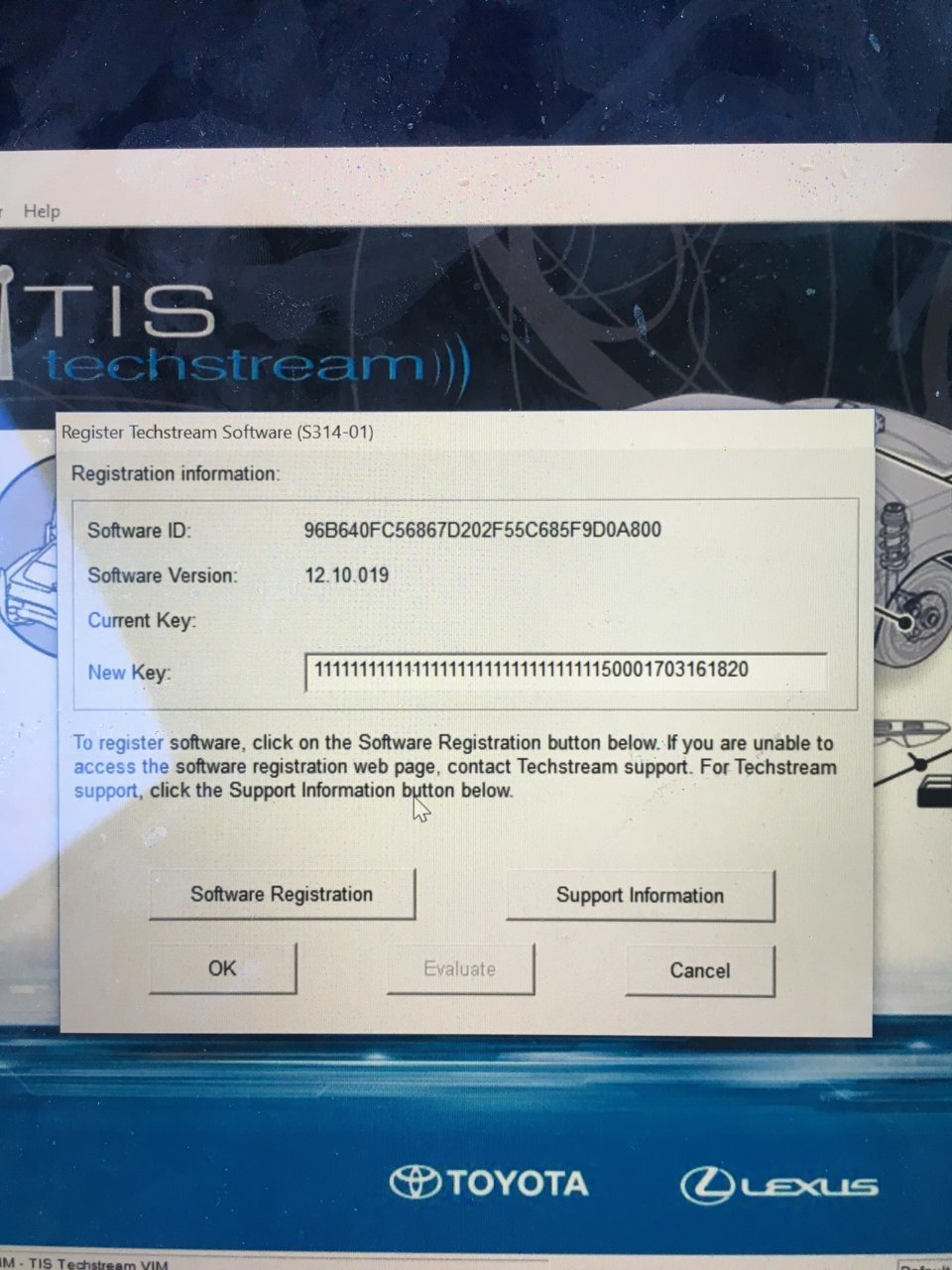

    Alright, so after multiple attempts, it looks like I successfully downloaded Techstream to my computer. I opened it and clicked “connect to vehicle”. When I did that, I was taken to a screen that asked for a new Key. I opened the Key.txt folder, copied the contents and then pasted it. Then, I clicked ok and the screen pops back up

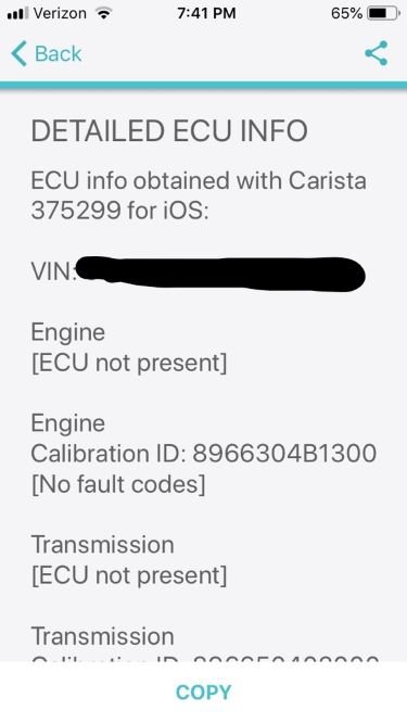

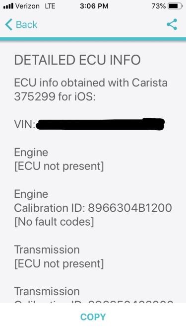

    Long time lurker, first time poster. Foss Toyota in Casper, WY did the update for me, just took in TSB-0125-18 print out with me and just leveled with the service adviser about wanting the update and they did it for me.
    Before: After:

    In the compressed folder you downloaded....there is a copy of the executable file. Search your computer for that file name where you chose to install the software. replace the executable file from the standard install using the one that was a copy from the compressed folder. Then try again. The standard executable is not cracked....the copy included in the compressed download folder is.
