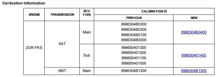

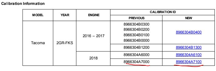

    Yes and no. Sort of. I don't think you will be successful if you go in asking for something particular that covers a range of model years. Just my hot take there.
    My script would be for your 2018:
    -- I have either surging at 40mph (TSB 58) or problems with steering in parking lots (TSB 125) (Pick One). I have read that there is an ECU update for my MT Taco. Can you please plug in TS and do a "Health Check." I am told that one will show up and if so, can you please apply it.
    If there is any resistance, you can whip out the TSBs:
    -- Show them this from 58 Page 3:
    That is your MT ECU even though it is in an "AT only" TSB.
    -- Show them this from 125 Page 3:
    That is a 2017 MT ECU. The same one as shown in 58 (above).
    -- Let them know that you are just trying to get your ECU updated to 04A71 and it will be if either TSB is applied.
    -- If you're feeling lucky, bet them $50 or a couple pizzas that it will load successfully.
