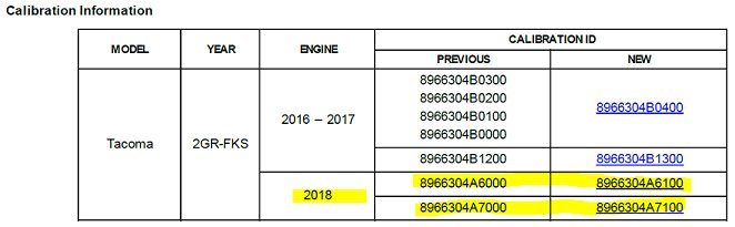

    Why is that? I thought OVT has all the latest factory tune improvements.
    My truck is a 18, A7000 calibration. I’ve tried, no dealer around here will do the update. 2018 MT is not listed on any TSB.

    It's listed under calibration information but under applicability, it only specifies 6AT.

    Yes and that’s the problem, AT. Toyota has these dealers scared to think on their own.

    just keep in mind that as far as we're all seeing, so many of these trucks show different outcomes. the ECUs& base calibrations were changing each model year. it has appeared to most of the MT crowd here that trucks before and up to calibration 04B12, mostly up to MY '17, got predictable results from the update, which upgrades calibration to 04B13.
    what info do you have on your truck? do you know your ECU version?

    You're a 04B11
