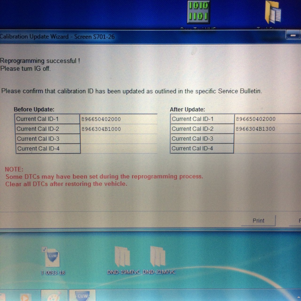

    I just flashed the update to my 2016 MT TRDOR myself and it went without a hitch. I used the T-0033-18 CUW file, the updater showed me that I was running a 4B11 ECU, it then flashed the file and once it was finished (total flash time was ~3mins). It then showed me that my ECU was updated to 4B13, as you can see in the screenshot I took of the confirmation screen.

    tony
    Lynnwood, WA
    Wow. Great job racking up the miles.
    That's a great update. I wonder if 04B10 would work also.

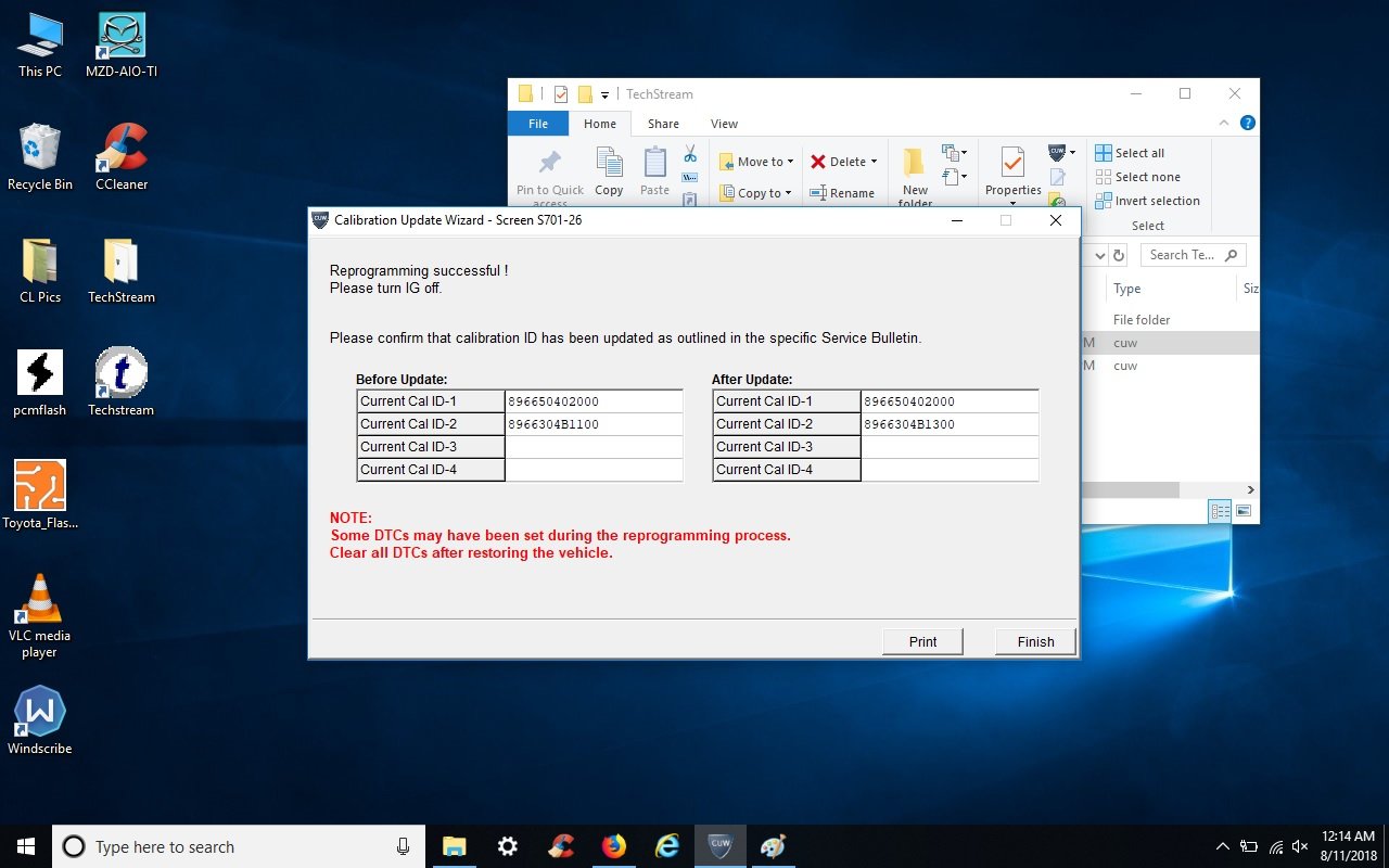

    Thank you sir, 04B11 confirmed updated.
