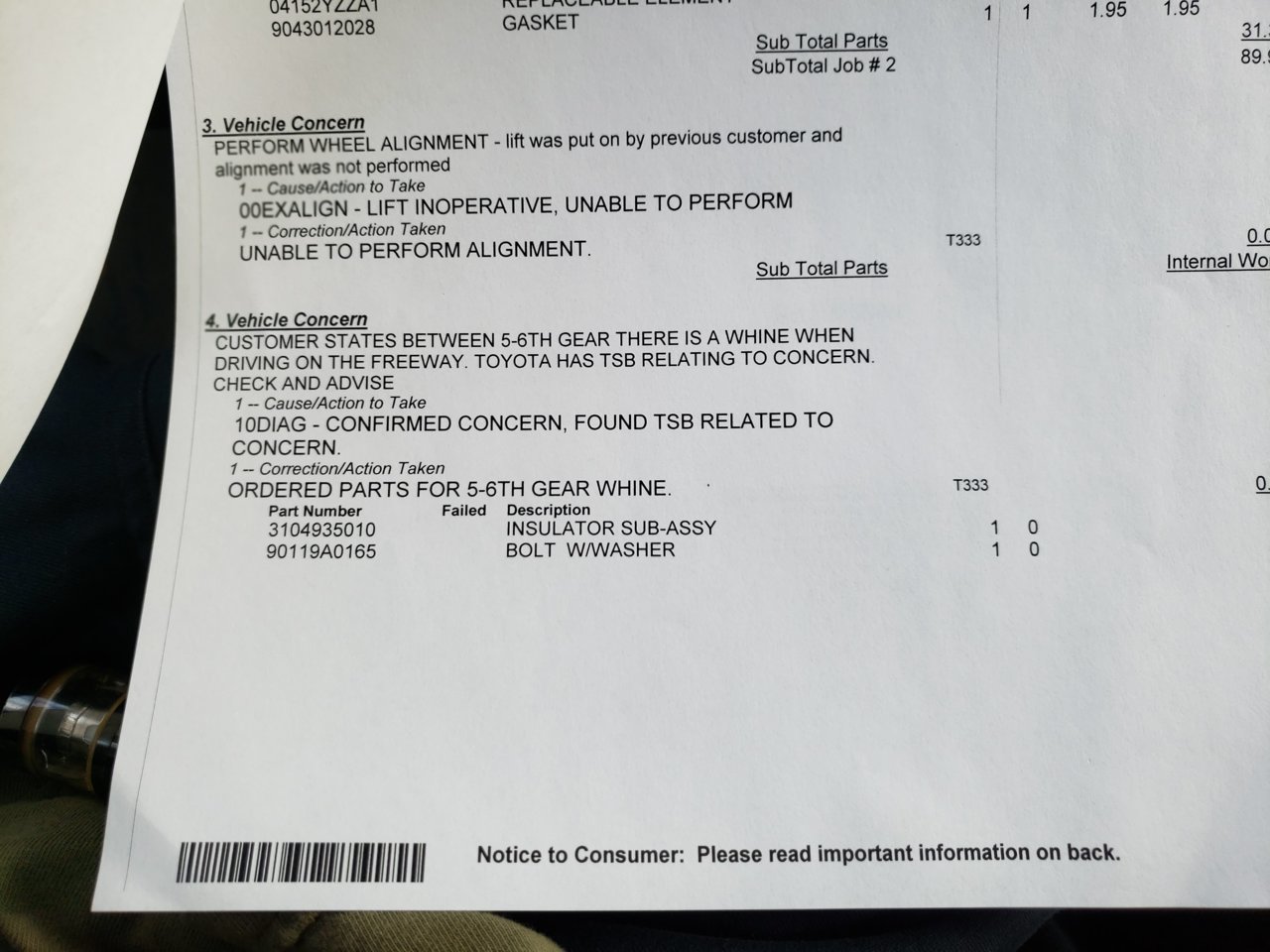

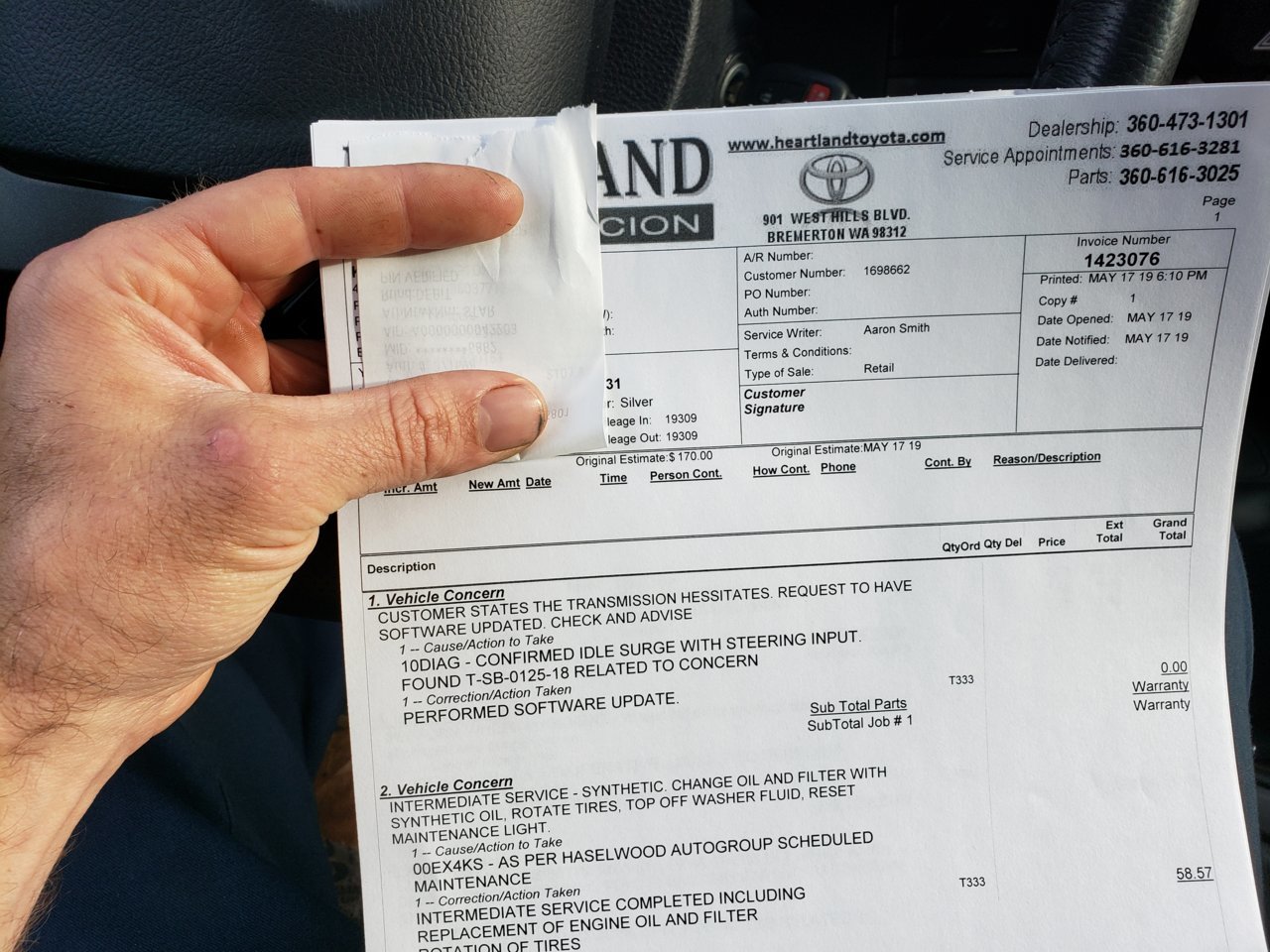

    21
    Kyle
    Bremerton, WA
    Sold 2017 DCSB TRD OFFROAD 6SP MANUAL
    Revtec 3"
    Just got the update. The truck feels much more responsive now. Engine braking no longer cuts off at 1500 rpm either. Heartland toyota bremerton, wa. They also ordered parts for transmission whine tsb.
