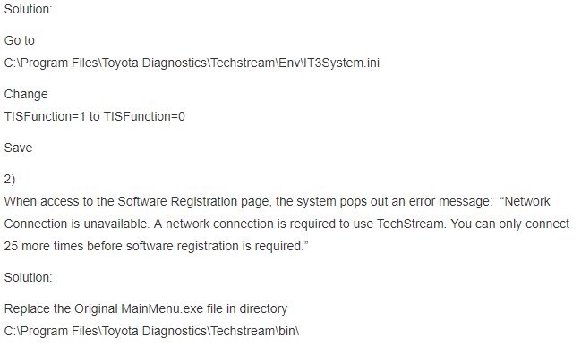

    If the key entry was messed up (didn't replace the EXE file first, you'll need to completely uninstall / reinstall.
  11. May 26, 2019 at 6:27 PM
    #2691
    xreadx
    xreadx Active Member
    Nov 19, 2017
    #236434
    32
    Daniel
    2017 Tacoma TRD Offroad MT
    Rims/Tires, GatorTrax Bed Cover, URD Short Shifter, OVTuned 1.05
    OMG after reinstalling I got it... I do not see this in original text The image that starts with "Solution:"(did I miss it?)
    Install TechStream through this first page on this thread. (do not launch program)
    Refer to my image after install if it loads. The text will not copy paste.
    If all els fails just keep reinstalling everything and go though the instructions over and it will work. I can now take "go argue with dealership" off of my to do list!
    Edit: I took it for a test drive after the update and put OVTune 93 octane back on it... Very very nice and worth the headache!!!!!!!!!!

    Good point. That step is skipped in the OP. My bad as I wrote that up for @Ruggybuggy to edit in. The video on the obdii360.com link does give those details though.
    I will ask Ruggybuggy to add the step.
    xreadx[QUOTED] likes this.

    @Ruggybuggy updated the OP to add the steps for replacing the maienu.exe file when installing TS.
    Hopefully that makes the installation easier?
