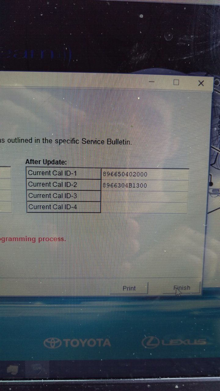

    Well I'm just waiting on my tactrix to be delivered by usps and update here I come!! Finally I can't ditch 04B10 and never look back! I've spent 120k miles with this tune, I hope everything works out. Now I just have to be able to follow the steps and install it. :fingerscrossed:

    Well success! And I can tell from the 20 miles I driven so far on the new tune, it drives like it should have from the beginning! No more damn stumble or hesitation, I'm impressed. I love this truck all over again, now it's time for that ovtune! Thanks everyone who has helped out on this thread, seriously!!

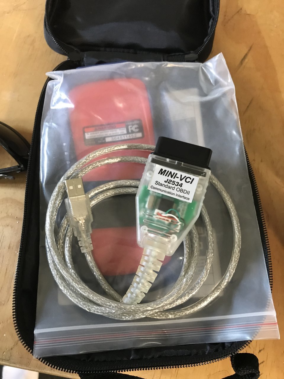

    I’ve used this cord to change the blinker tap duration and seatbelt beep. I used the 32-but emulator from the ih8mud forum. Will that setup work to do this update? Sorry if it’s covered, I read through 5 pages to look for the “why” behind the warning in the original post and got tired of clicking.

    No one AFAIK has successfully run the update with that style cable. One or two have actually semi-bricked their ecu's using it, and had to send them in to ovtune to get fixed.
