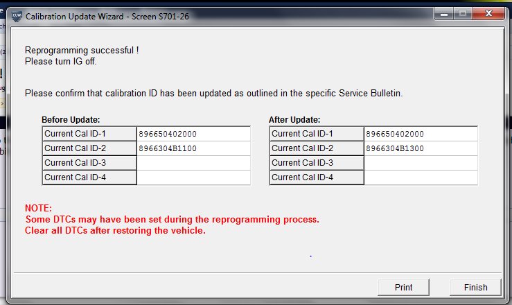

    Late to the party, but just updated and about to take her for a spin!

    I am planning to order OV Tune kit. Given that I am flashing OV tune do I still need to flash this TSB? Before or After OV tune? Thank you.

    You don't have to apply the TSB to run the OV tunes, but you really want to. 04B13 is a way better baseline than 04B12. From there, you load OVT.
