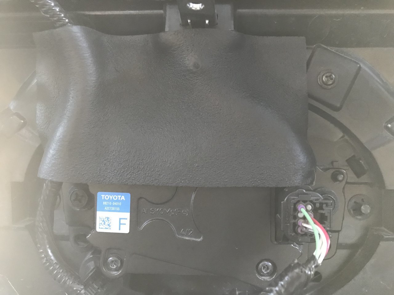

    Where does this piece go?

    They stick the foam behind the radar device.
    (Not my photo)
    Pablo8[QUOTED] likes this.

    I guess slows gross water intrusion and dampens vibration.
