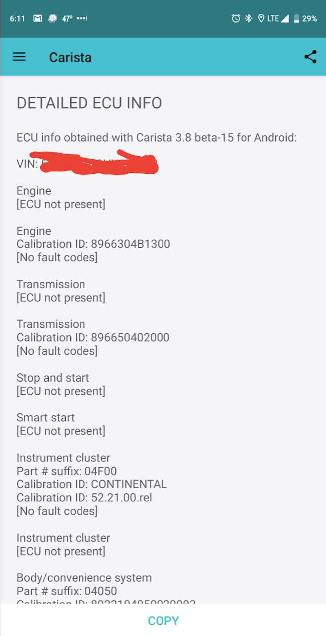

    No problem. You're welcome!
    It is a very cool app. I only wish they had a lifetime subscription. It was offered a long time ago, but they changed that.
    Here's what you're looking for in the app:

    Cool, thanks!
    Just wondering why is yours 04B13? Isnt 04A71 the latest? Im still kind of confused with this, so bare with me:D

    You're welcome!
    No worries. With changes, each model year gets a new ECU ID, sometimes two depending on switches at the factory.
    2016 was 04B10 and 04B11 - there was some suggestion that there might have been some hardware changes on the line.
    2017 was 04B12
    The TSB tune makes all those 04B13.
    2018 was 04A70 - big change with the TSS-P stuff
    The same TSB tune makes those 04A71.
    2019 was 04B30 and 04B31 - it is rumored that there will be a TSB at some point for the 04B30s?
    2020 is 04B90
