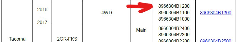

    You might also try TSB-0013-19 (attached). The symptom is interesting, but it at least lists the MT Tacos. TSB-0058-18 and TSB-0125-18 were revised to remove the references to the MTs ECUs, even though the CUWs apply to us.
    From Page 6:

    Some dealers did the early TSBs because they referenced the MT ECUs. After the revisions it got harder. If your previous conversations lead to them just looking for some kind of billable coverage, then take copy of TSB-0013-19 along with you. That at least shows your ECU and the update. It is all the same software that gets you to 04B13.
