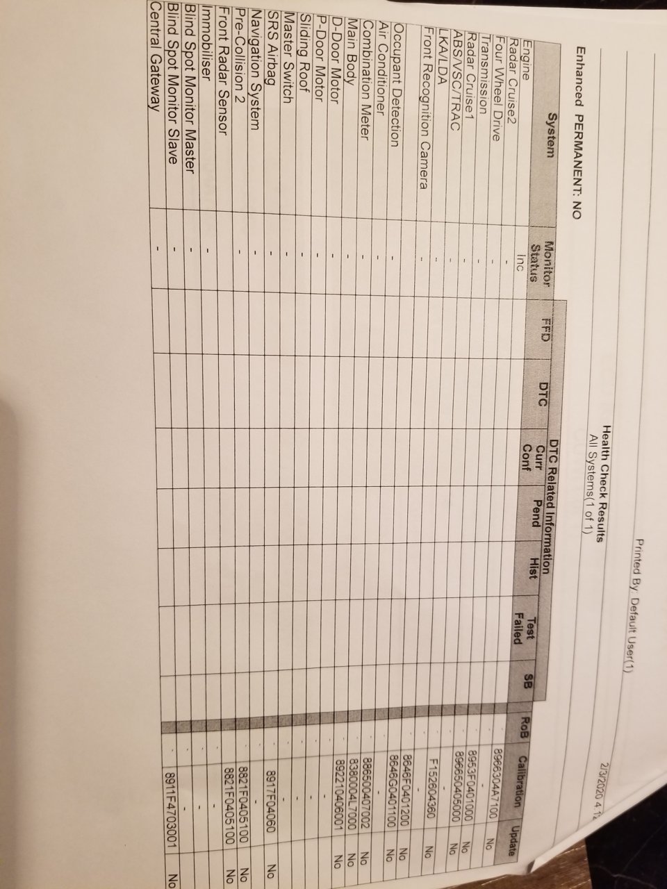

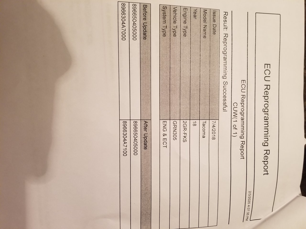

    Well boys, i got the update done today. Im on 4A7100 now. :devil: Complained that the engine surged at 60-80 km/hr.
    At first, the advisor said its for AT only and i said its for MTs as well. He went on his computer to check and realized there is tsb for MT as well.
    I only drove about 20 km on it, so not much, but i did notice a bit more torque down low? Or am i just imagining things? im not sure. I mean my truck drove fine before, my biggest complain still is the throttle response, but its not a huge deal, ive learned to live with it.
    I obviously didnt read the whole thread, but what were the biggest changes for some of you guys?

    Nice work!
    Yes, there definitely is a small power bump. I could pull hills on gear higher than before.
    Relaxed shifting was the biggest benefit for me.
    Junkhead[QUOTED] likes this.
