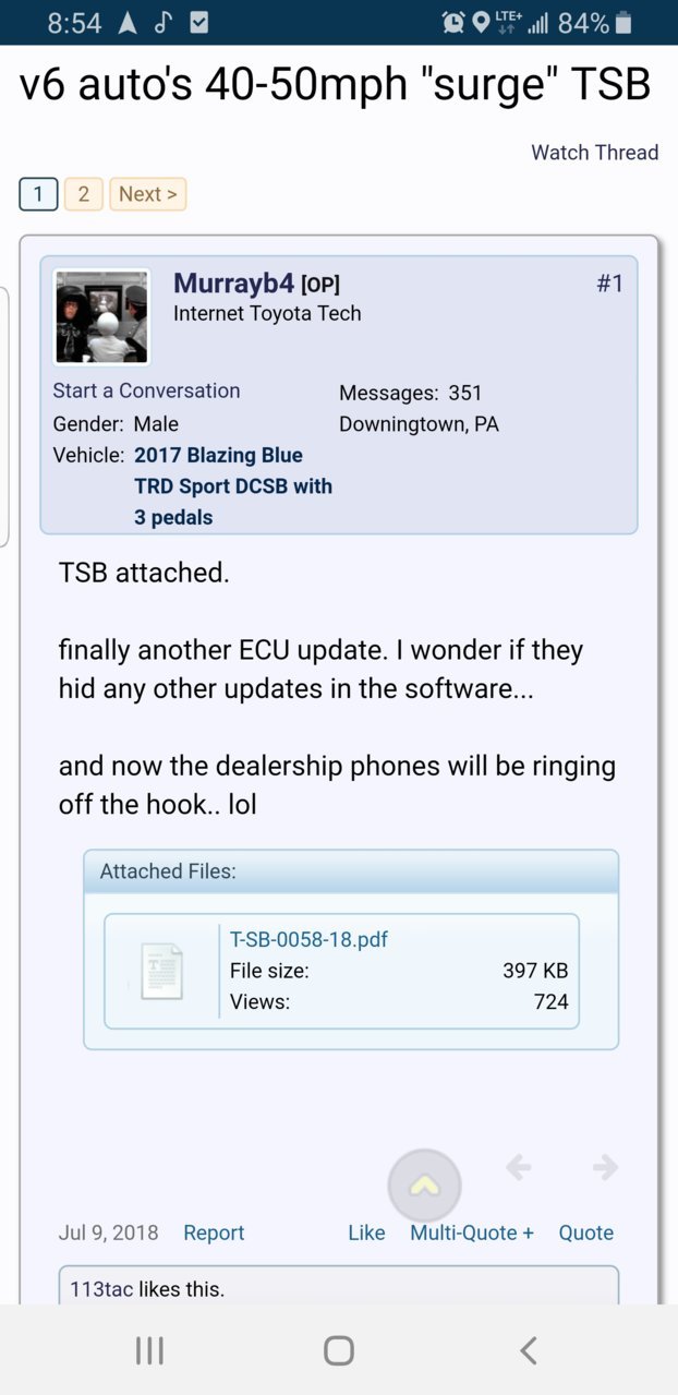

  6. Feb 6, 2020 at 8:57 AM
    #2986
    Junkhead
    Junkhead TRDude
    Feb 27, 2019
    #284671
    15,688
    Serge
    Prince George, BC
    Black 4x4 Sport MT 2018
    Some Serious Tires
    Thats crazy man. It took my service advisor 2 min to find it on his computer. Ill send a photo of the tsb printout they gave me when im done work.
    I actually showed him the pdf from TW and he looked at it and said: ya no problem we will do it. It says for auto only but he didnt say anything to me.
    Thats the pdf i showed him. Hope this helps, good luck man. Ill get some pics later on.
    tonered[OP] likes this.
  7. Feb 6, 2020 at 9:06 AM
    #2987
    tonered
    tonered [OP] bartheloni
    Sep 25, 2017
    #231055
    31,330
    tony
    Lynnwood, WA
    For MTs, you have choices of TSB-0058-18, TSB-0125-18, and TSB-0013-19. As far as I know for the latest revisions of those TSBs, only that last one still lists MT Tacos. The original revisions of the first two listed MT ECU IDs.
    The CUW software posted in this thread came from TSB-0058-18. No one has posted the CUWs from TSB-0125-18 or TSB-0013-19. As the updated ECU IDs are the same (04B13 or 04A71), there is no reason to think that the software would be any different.
    Junkhead[QUOTED] likes this.

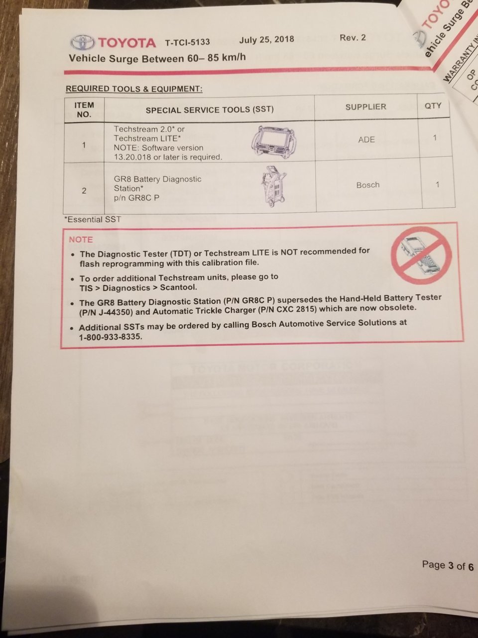

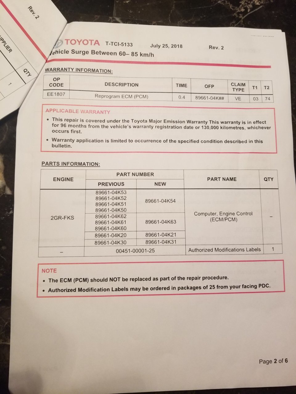

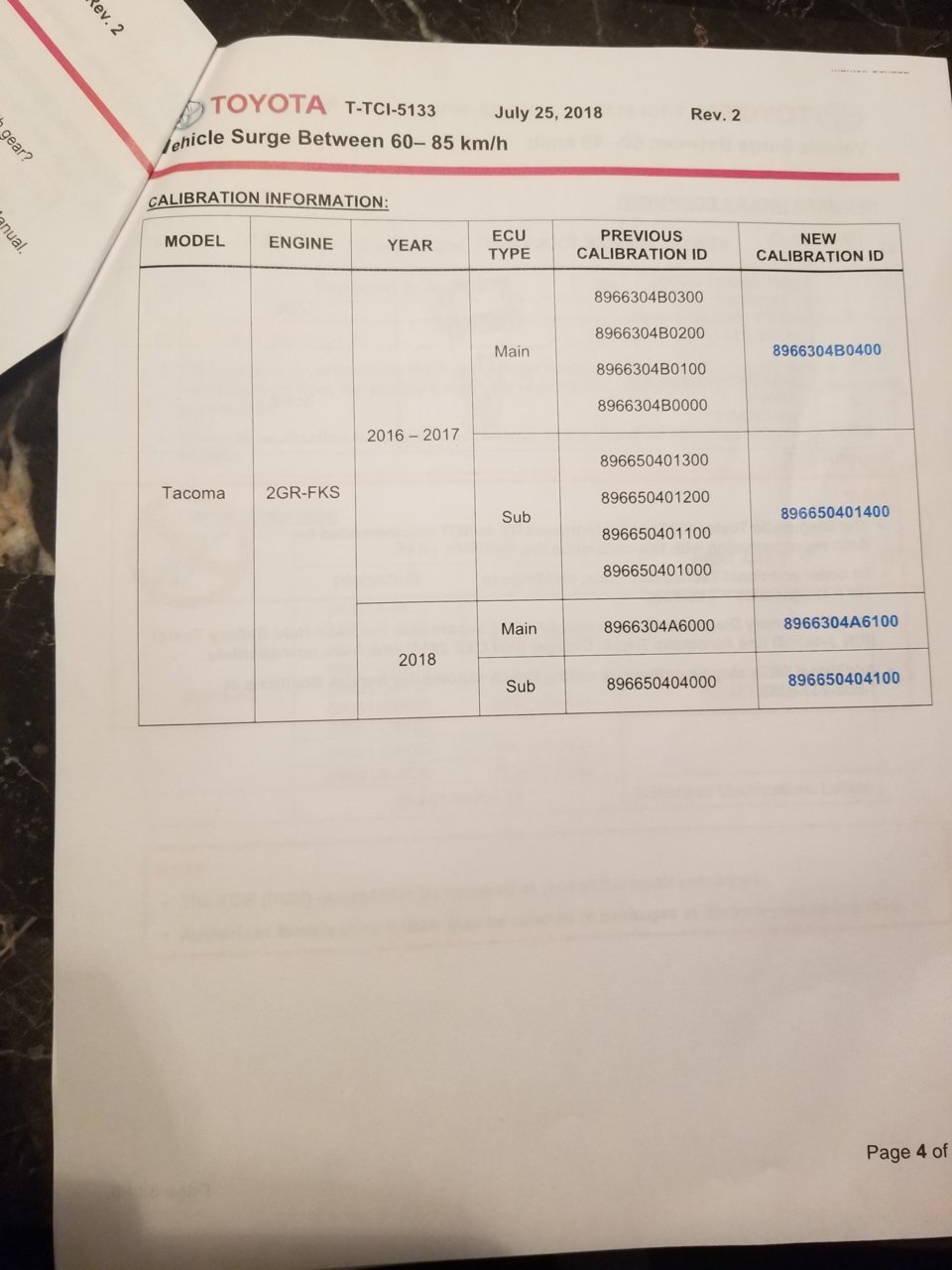

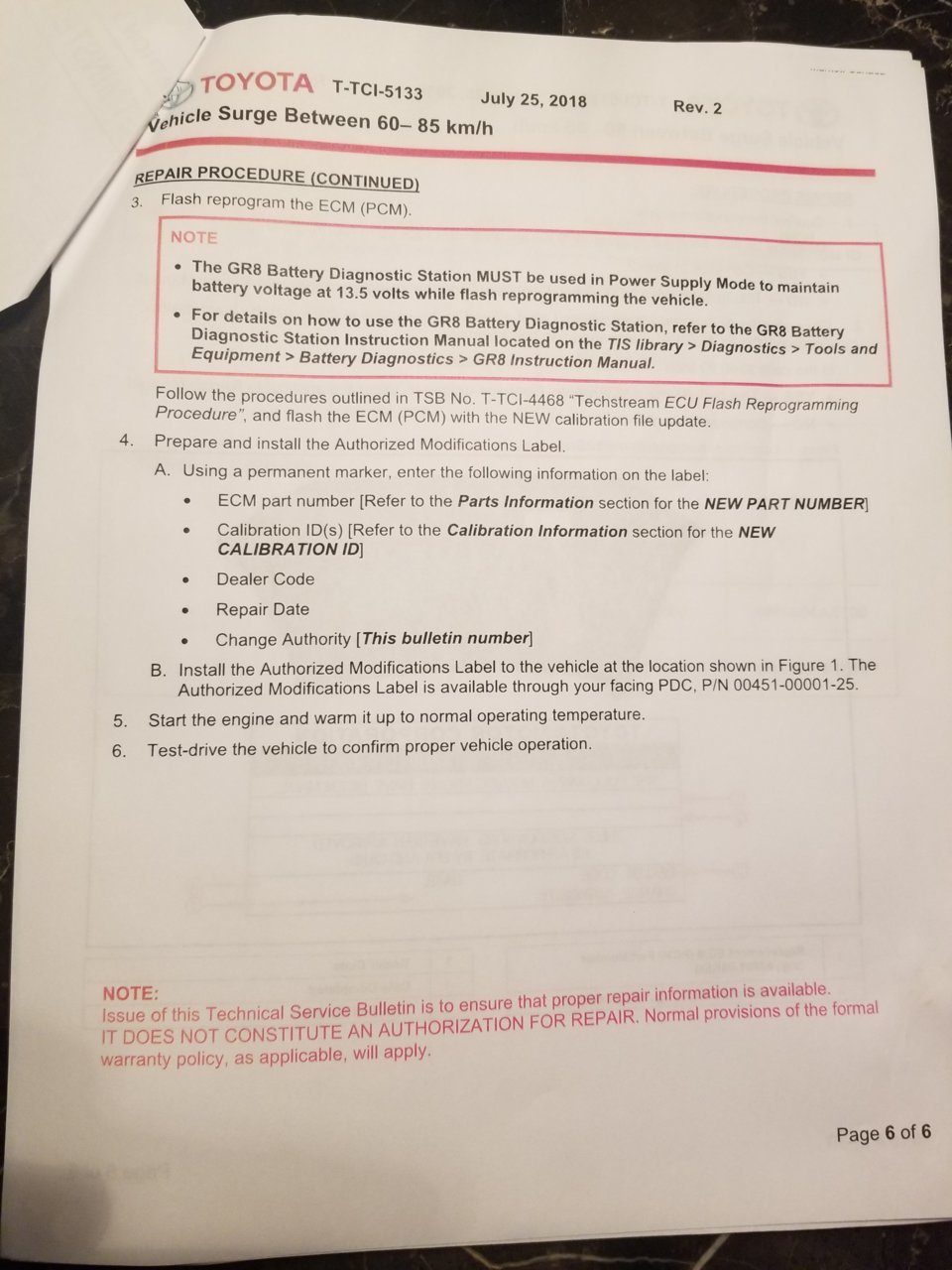

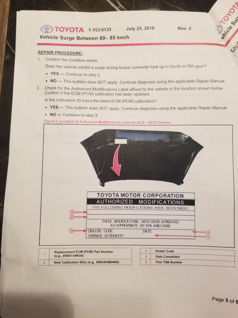

  15. Feb 6, 2020 at 12:07 PM
    #2995
    18TRDOR
    18TRDOR Well-Known Member
    Jun 27, 2018
    #257641
    128
    Kyle
    New Philadelphia, OH
    2018 TRD OR DCSB 6MT
    I would gladly do it myself, I just did not feel like going out and buying a PC based computer to do it. Haha.
    Its looking like I'm going to have to though.
  16. Feb 6, 2020 at 12:13 PM

  20. Feb 6, 2020 at 7:34 PM
    #3000
    tonered
    Sep 25, 2017
    #231055
    31,330
    tony
    Lynnwood, WA
    I forgot that Canadian TSBs are different than US TSBs. Ugh!
