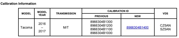

    Yes. There is never a need for intermediate steps. 04B10 to 04B14 is perfectly fine.
    Both the TSB and the header data in the CUW file say the same:

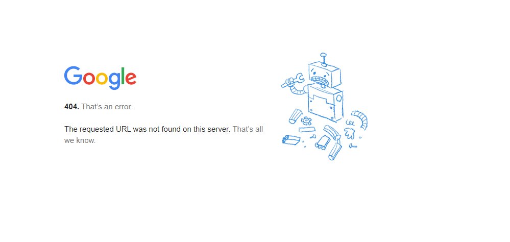

    I'm not having much luck getting a dealership to perform either the T-SB-0125-18 or T-SB-0043-20 on my truck but I am very curious to try it out. Unfortunately the link to the map of dealerships known to actually perform this TSB seems not to work on my computer.

    It looks like the map page is gone?
    @jkcashin , do you know what might be happening here?
