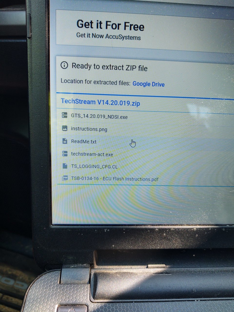

    IMG_20200813_154551576_HDR.jpg which is cuw?

    thats techstream
    The CUW (TSB) are a separate download. Attached in the first post of this thread.

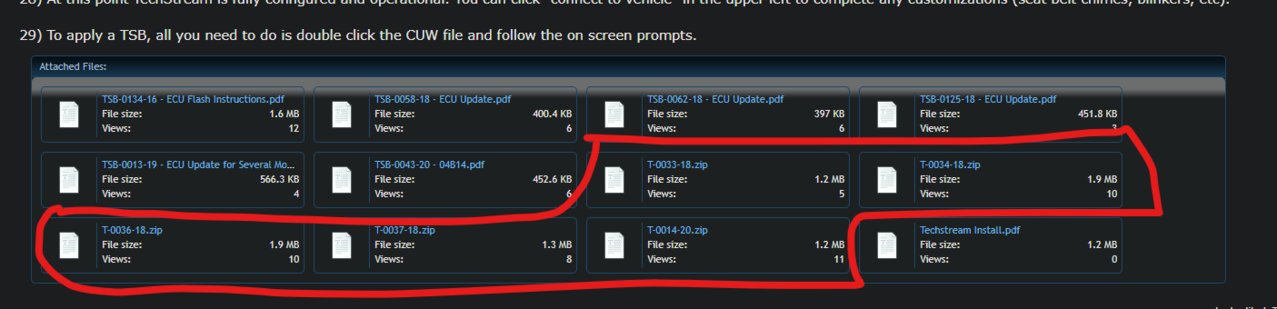

    These guys:

    Tune: Nexus +P Add ons: +3" custom suspension 295/70/18 Yokohama M/T Tires KMC XD Grenade OR wheels KN intake Blackhawk MBRP Exhaust TJM Rock Crawler Bumper Lighting (+10 H.P.)
    Found them. Just do the T0034-18 one?

    Yessir.
    Just put that CUW file on your computer desktop.
    Plug in the Tactrix.
    Ignition Off.
    Double click on the file (TS closed).
    And, follow the on-screen instructions.

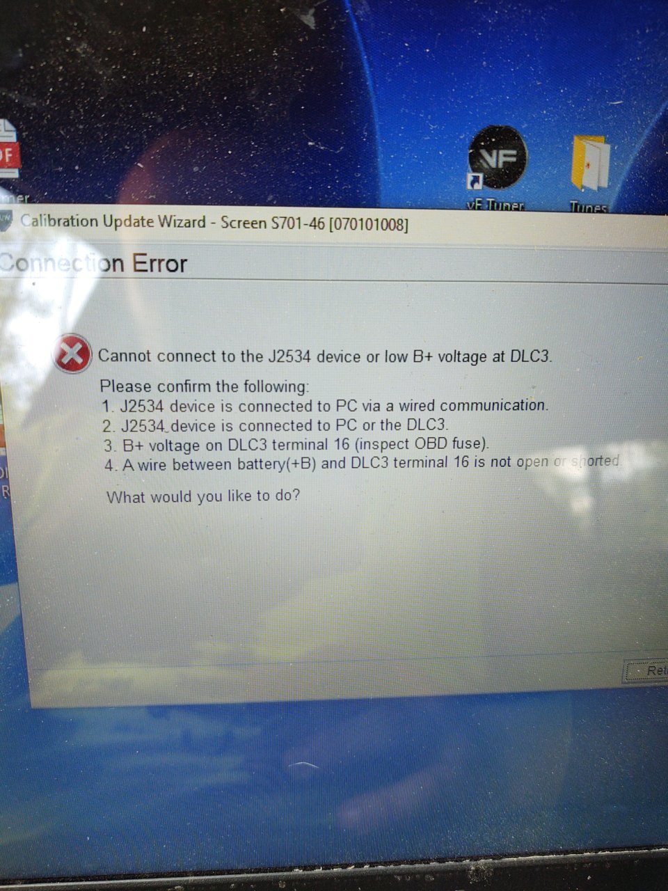

    did you do the VIM select in TS and verify it can connect to your truck?

    Launch TS. Go to the VIM menu. Select Setup, I believe, and pic the OpenPort drivers from the dropdown menu.
    Close TS and hit the CUW again.

    Yes. Then I tried the CUW file and it said I had to close TS

    Starting with the ignition off and Tactrix plugged in, I believe the next screen says to go to On without the motor running?

    so you plug into the ODB2, Plug in the USB, Launch TS, ignition on (motor off) and click connect to vehicle and it is successful?

    Says unable☹️
    Ignition on. Plugged in. Chose open port 2.0
