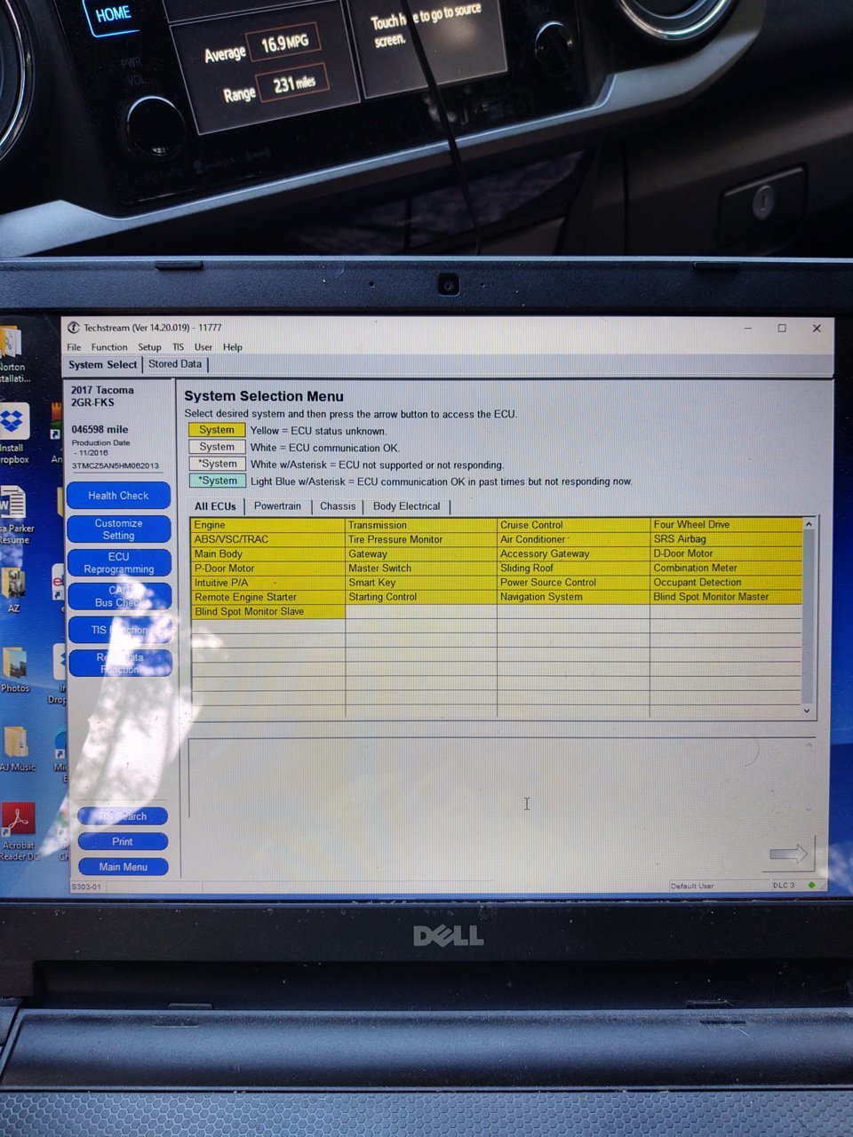

    ignition on as in 2 clicks of start button with foot off brake

    Lynnwood, WA
    Yes! That is the way.

    tony
    Lynnwood, WA
    Excellent. You got a solid TS connection.
    Note that Customize Setting menu on the left. You can change the seat belt chimes and such in there (later).
    Now, close TS. Shut the Taco off. And, hit the CUW again.

    Shellshock
    Nov 21, 2015
    #170338
    23,210
    Iowa
    you can leave it on and run the cuw.. like the first step is turn ignition on

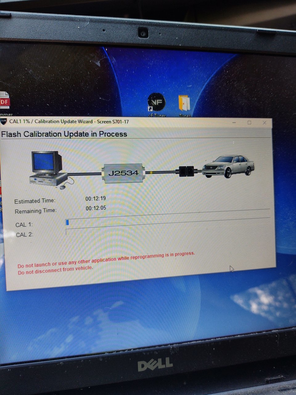

  11. Aug 13, 2020 at 2:35 PM
    #3231
    Mooseditty17
    Mooseditty17 Seasoned Rookie
    Apr 7, 2019
    #289395
    1,681
    AJ
    WI
    2017 TRD OR : M+W Nexus Tuned
    Tune: Nexus +P Add ons: +3" custom suspension 295/70/18 Yokohama M/T Tires KMC XD Grenade OR wheels KN intake Blackhawk MBRP Exhaust TJM Rock Crawler Bumper Lighting (+10 H.P.)
    IMG_20200813_163322100_HDR.jpg warning lights and shit like I'm doing an OVTune is normal I assume. After this is all done I go get the 04B04 OVT files and flash the one I want using VF tuner correct?

    #170338
    23,210
    Iowa
    normal
    yup. at the end it'll give a confirmation showing what revision you were on and what you are on now.
    in vF tuner you can hit identify and verify as well. then flash whatever 04b04 tune you want
