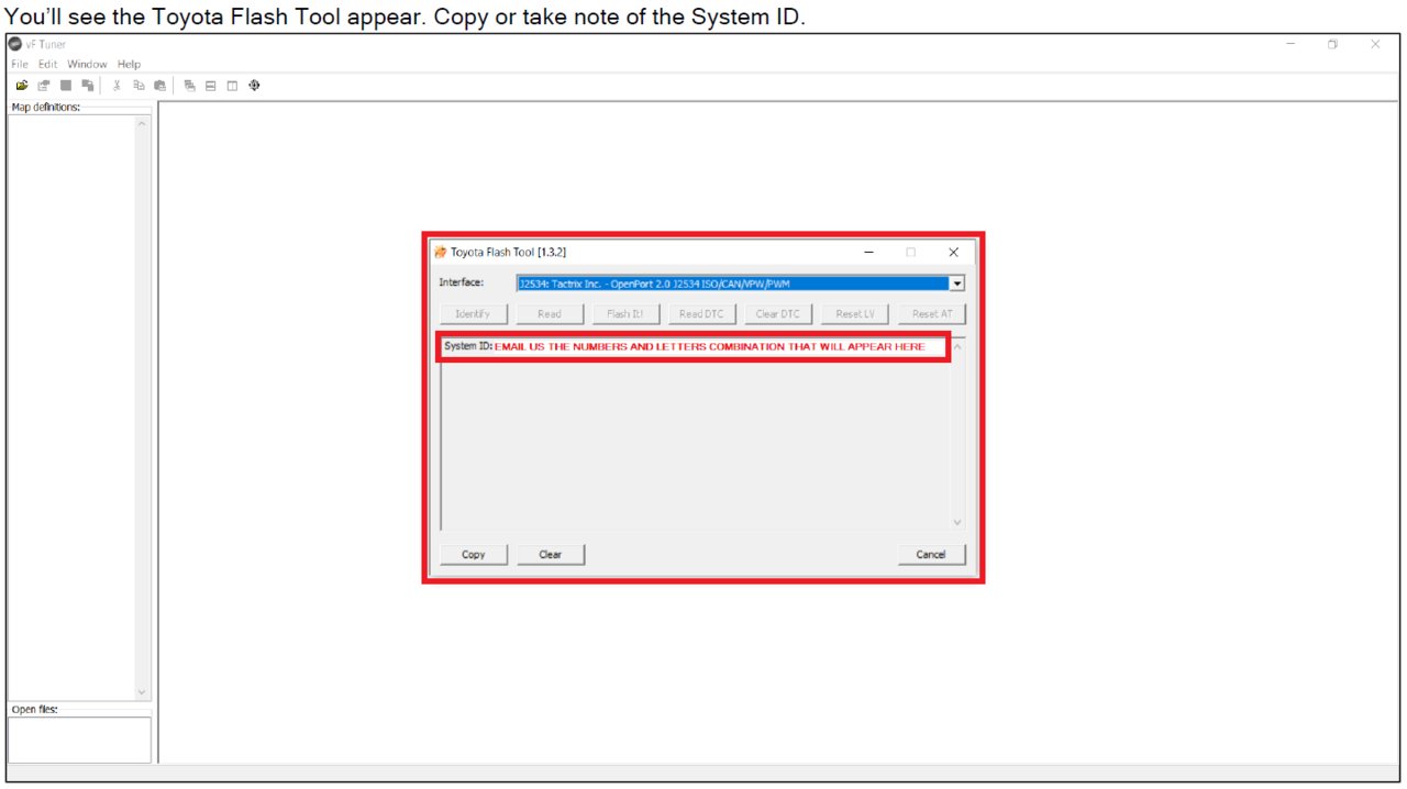

    You can apply for the REG file and Tune Pack now, if you want to.
    Install Flash Manager:
    https://www.ovtuned.com/blogs/news/flash-manager-1-3-0-released-with-new-logger
    or vF and launch it on the computer that you want to tune with. The Flash Tool will give you the System ID to request for the REG file.
    If you can determine your ECU ID, you can also request the Tune Pack at the same time. You can use OBD Fusion or Carista apps if you have a Bluetooth OBD adapter.
    This way, you should be ready to flash when the OVT / Tactrix arrives.

    I have Techstream, I assume I can pull the ECU ID with that and Tatrix
    wrightme43 and tonered[OP] like this.
  19. Aug 14, 2020 at 10:36 AM
    #3279
    tonered
    tonered [OP] bartheloni
    Sep 25, 2017
    #231055
    31,195
    tony
    Lynnwood, WA
    That is the best route! I was going to ask if you had the Tactrix.
