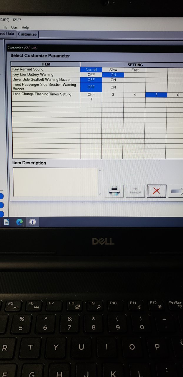

    You won't and you can't disable airbags. Here is what one of the customization menus looks like. For all of the options, its either an On, Off or some other option. I've been over all the submenus and you can't even customize any of the radar/safety sense stuff. Look, if you're not comfortable poking around then settle for generic OBD or something more expensive to get more PIDs. If you want to get a dealer-level tool, this is the way to go. You don't have to flash TSBs if you're leery.

    That looks stupid simple. I must not have been in the right area for customizing... thanks

    I turned off the passenger seat dinger because my dog loves to ride. It still flashes at me on the dash.

    Yes. That does not go away.
    Personally, I am okay with it.

    Not sure how I missed the Uber obvious customize button. I feel dumb now. Thanks again for all the help prior. Everything works wonderfully since the TSB update and Tune. Approaching 400 miles now, and it's settled in beautifully.
