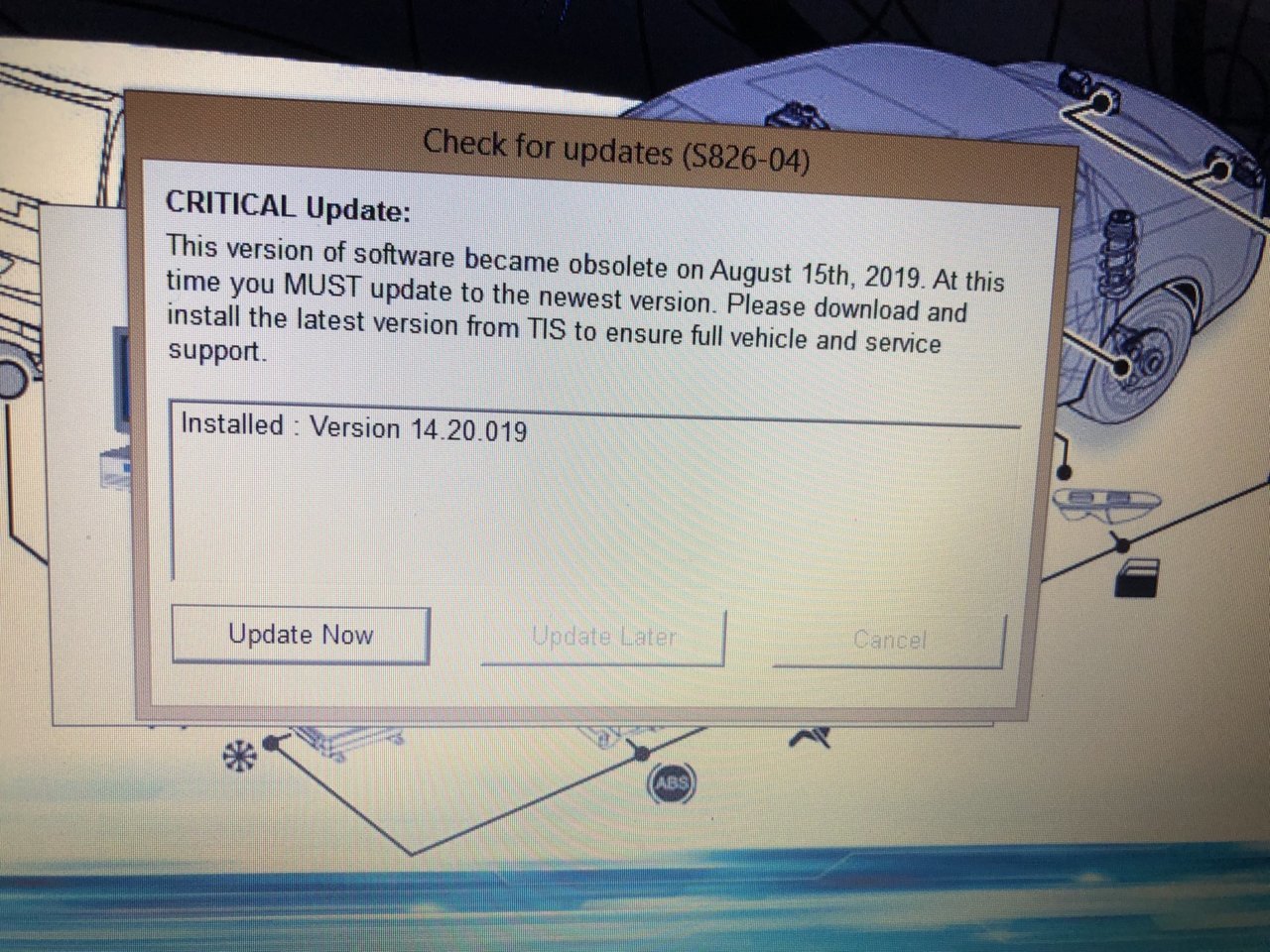

  5. Aug 27, 2020 at 6:35 PM
    #3345
    xLOGREx
    xLOGREx Well-Known Member
    Feb 11, 2020
    #318977
    246
    Logan
    SL,UT
    2017 White SR5
    Little of this, little of that.
    What did I do wrong? :anonymous:
  6. Aug 27, 2020 at 6:37 PM
    #3346
    mZiggy
    mZiggy Honey badger
    Apr 8, 2017
    #215707
    4,709
    Marc
    2020 MGM Tundra SR5; 2020 4R TRD Pro; 2008 4R SR5 v8
    You didn't do anything wrong, it's basically saying there's some sort of mandatory update to a newer version of Techstream and that you'll need to install a newer version

  7. Aug 27, 2020 at 6:39 PM
    #3347
    mZiggy
    mZiggy Honey badger
    Apr 8, 2017
    #215707
    4,709
    Marc
    For the record, maybe you can figure out a way to bypass that warning, ignore the necessity of updating. Idk. Could try using the program without being connected to the internet
    tonered[OP] and Shellshock like this.
  8. Aug 27, 2020 at 6:41 PM
    #3348
    Shellshock
    Nov 21, 2015
    #170338
    23,239
    Iowa
    i've never seen that screen. id just close TS and open it again. if it asks to check for updates, always click no
    tonered[OP] likes this.
  9. Aug 27, 2020 at 6:45 PM
    #3349
    xLOGREx
    Feb 11, 2020
    #318977
    246
    Logan
    SL,UT
    2017 White SR5
    It’s weird, it will only let me select to update and when I select it, it opens a browser and asks for a dealership login.
  10. Aug 27, 2020 at 6:56 PM
    #3350
    wrightme43
    wrightme43 Well-Known Member
    May 10, 2020
    #327619
    1,200
    Steve
    Scottsville Kentucky
    17 Double Cab M/T TRD Offroad Blazing Blue Pearl
    Redline custom leather shift and e-brake boot. VFTUNE Super Full Otto cycle, octane learning, premium fuel.
    Did you turn off your wifi? It should open in limited mode.
  11. Aug 27, 2020 at 6:57 PM
    #3351
    Shellshock
    Nov 21, 2015
    #170338
    23,239
    Iowa
    did you use the download from the first post of the thread? have you had it setup for a while or are you trying to get the initial install done?
    also if you disconnect from the network, it shouldn't check for updates on startup.
    wrightme43 and tonered[OP] like this.
  12. Aug 27, 2020 at 6:57 PM
    #3352
    tonered
    tonered [OP] bartheloni
    Sep 25, 2017
    #231055
    31,087
    tony
    Lynnwood, WA
    Interesting.
    But, a ton of us have used it since 2019. :D
    I'll check in the morning. Otherwise, you could try reinstalling? Remember to stay offline.
    :cheers:
    wrightme43 and xLOGREx[QUOTED] like this.
