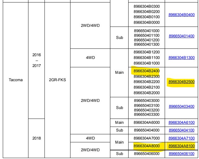

    That is a good question there. I do not have those listed in the 1st Post and will update it. The only breakdown that I see there is in TSB-0013-19.
    04B25 is 2016 / 2017.
    04A81 is 2018.
    Transmission type is not noted.

    81 should be 2020 no?
    tonered[QUOTED][OP] likes this.

    I know I came across a B24 AT, so idk what the Mexico/SA MTs are
    tonered[OP] likes this.

    tonered
    tonered [OP] bartheloni
    Sep 25, 2017
    #231055
    31,211
    tony
    Lynnwood, WA
    With an 'A.' It took me a few blinks to catch on to that one.
    Just highlighting what I assume is non-USDM?
