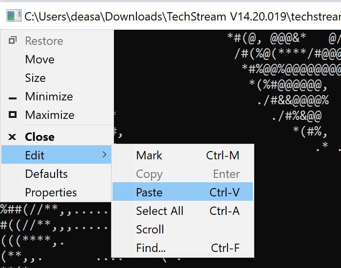

    Flawless setup instructions from @Shellshock
    Only thing worth possibly mentioning and I'm not sure if maybe I already enabled copy & paste for cmd shells but I _think_ it _might_ be possible to not have to change those settings and leverage the menu for a "I just need to copy this one thing this one time and I don't really care about the command prompt at all" sort of situations?
    To paste in the software ID:
    To copy out the activation key:
  3. Oct 25, 2020 at 10:39 PM

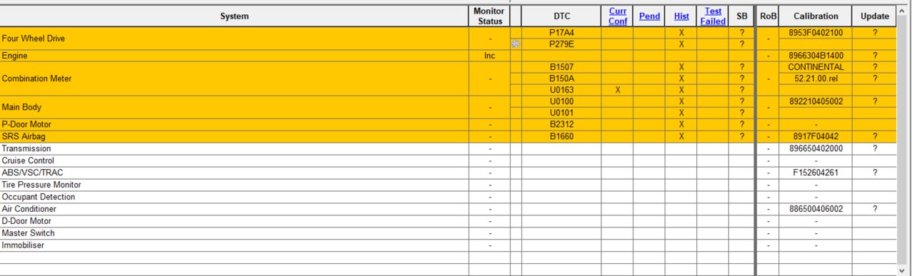

    My first question is where to find what I'm running right now. Hmm... starts as all yellow then when clicked goes white. But yet I see nothing interesting yet
    OK, I’m guessing health check is the way. Looks like I was on 04B1100 from what I saw. Attempting 04B14 cuw.
    I'm thinking I got the flash going, though I clearly failed at registering the new key. Gonna try a little test drive now.
