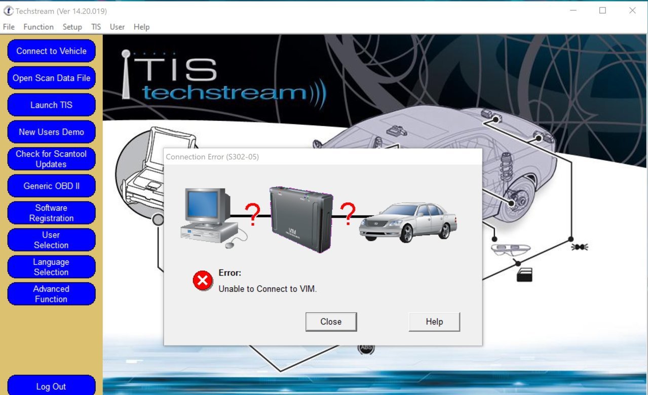

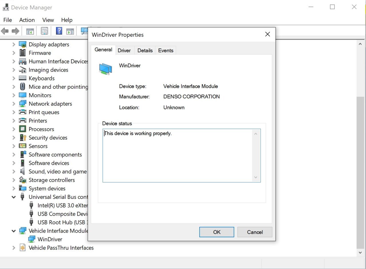

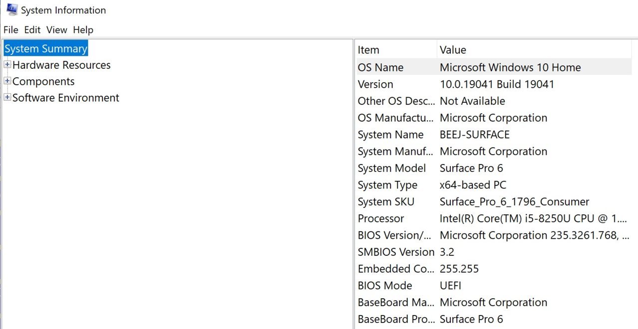

    Can't connect. Win10, Tactrix cable, 2020 Tacoma OR.

    Did you select the interface in techstream?

    I did now, thanks.

    Install the Tactrix drivers and select the Tactrix interface in the Setup menu.
