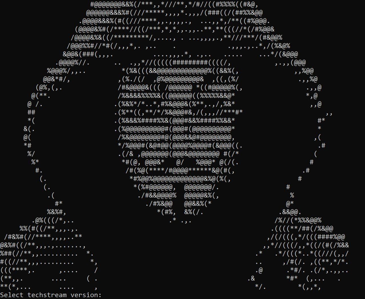

    Thanks OP @tonered for the incredibly well put together thread. Kind can’t believe I’m able to do all this myself now and super stoked about it. Everything was clearly laid out and the instructions were awesome, and any questions I had were easy to find via search. Definitely got a giggle at that Guy Fawkes drawn in code for the techstream key :rofl:

    The key gen program is crazy. I get a good laugh now, but that first time . . .

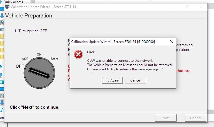

    Hey guys,
    I'm getting this error message when I am attempt to run the CUW file. Can anyone help? should I just click out of the pop up and continue the flash?

    Just click Cancel.

    You should not be on the Web when you Flash or run the .cuw files.
    You do not need to have TS open to update your ECU.
    Just double click on the .cuw file ( I'm assuming you have TS installed ? )
    Follow the prompts. Make sure you turn off EVERYTHING on your truck .... and your battery is in good shape.

    ok, clicked cancel. Yes I have TS and it is closed. Followed the prompts, flashing in progress.

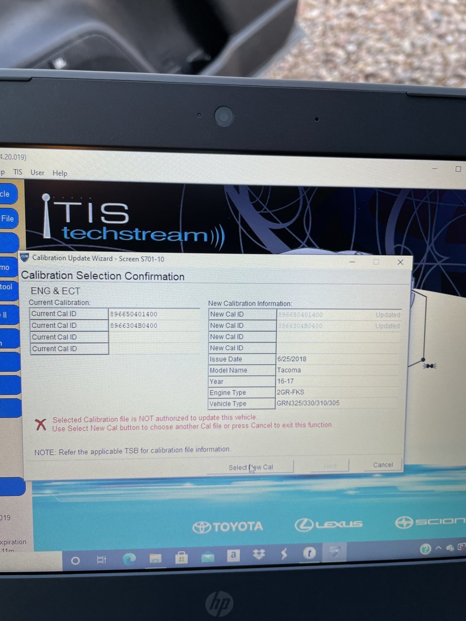

    Anyone know why I’m getting this message? Attempting to go from 04B00 to 04B04

    Do you have the proper .cuw file ?
    TS will not allow you to update ...... with the wrong ECU ID.

    Looks like your current ID is 04B04...

    Yep .... I missed that !

    Lmao thanks. I thought that might be the case but digging though my records it looked like I was 4 versions back and 04B04 was the new version of 04B00 that I didn’t have. Oh well I guess I’ll let the new AGM charge while I’m plugged in. Anything cool I can do in the meantime or should i just wait for OVTune to complete my system registration? *facepalm*
