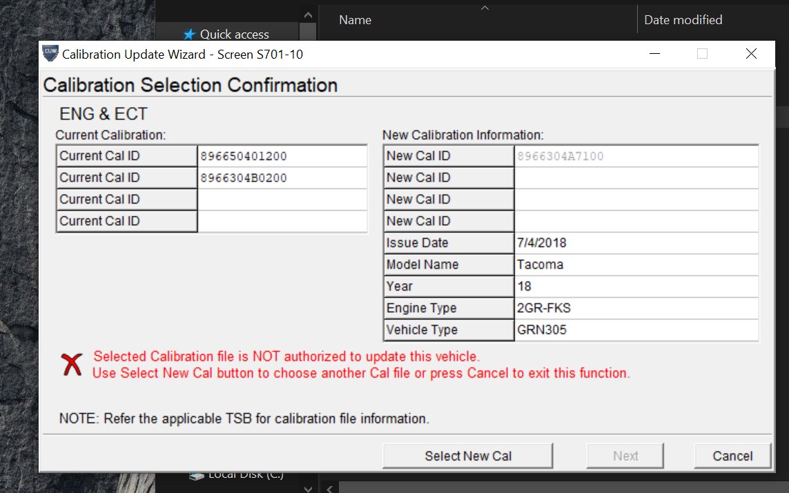

    So I used the hint guide for my truck in the first post, but those TSB's don't seem to be in the download area for my truck.
    It's not an 18, it's a 2017 TRD AT. What current CUW file should I be using? I just tried 0037-18, and that's not the first file I've tried.

    The file name in your text is correct, but the screenshot isn't the right file, I believe.

    That's what the file name is that I downloaded, weird.

    I mean, I could be wrong. I just did this yesterday and didn't have a problem. The file names were correct on both sides from what I remember.

    There's a screenshot of the correct stuff in post #3645.

    You need T-0034-18.cuw for a 17 AT

    That was it. Came back to tell good news and yes it’s done. It’s been about 2 weeks since trucks been driven so had to hook the jumper cables to it as well.
