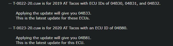

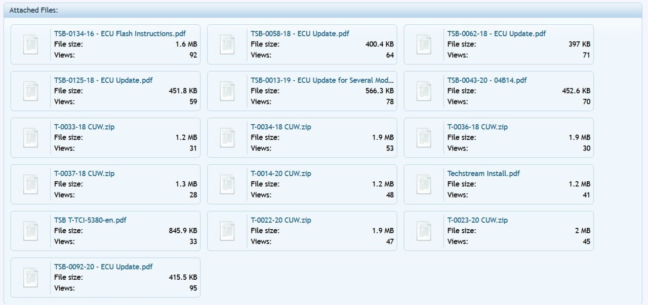

    I've been waiting for an TSB like others have mentioned and just ordered the Tactrix OpenPort2.0. I'm going to BootCamp my Mac with Win10 and disable Windows Defender to do the flash. I have all the TS software and keygen but for the life of me I can't find the T-0092-20 CUW zip file in the first post. I see the PDF but not the CUW. Am I blind?
    tonered[OP] likes this.
  11. Dec 2, 2020 at 2:10 PM
    #3671
    tonered
    tonered [OP] bartheloni
    Sep 25, 2017
    #231055
    31,108
    tony
    Lynnwood, WA
    Only half blind. :santa2: I kept the CUW file names as Toyota named them. There can be more than one CUW for each TSB.
