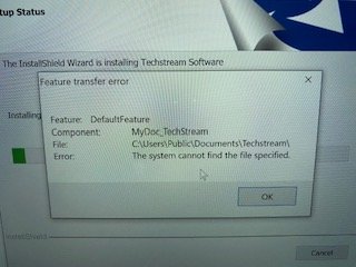

    hello group,
    i was trying to download techstream but i kept getting an error. can anyone give a good link to download it
    thanks

    I just downloaded it a few minutes ago from the link in the op.

    Yep, I just tested the link as well. All good here. Is the issue downloading or unzipping?

    downloading it, i keep getting this message:

    You may have a corrupt download? That's a new one to me. Try the link in my signature? Also, make sure your AV isn't quarantining or deleting anything.

    i'm still getting the same error message

    It finally worked, thanks for the help
