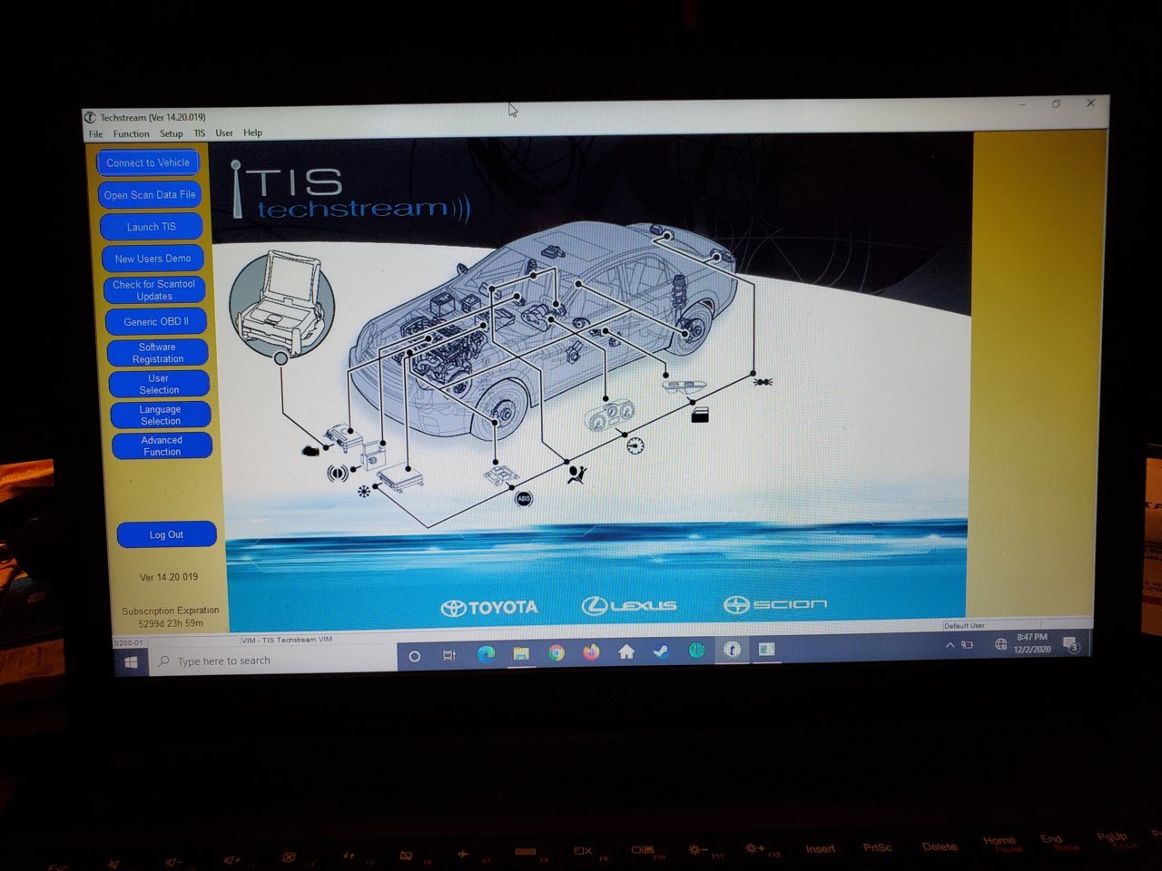

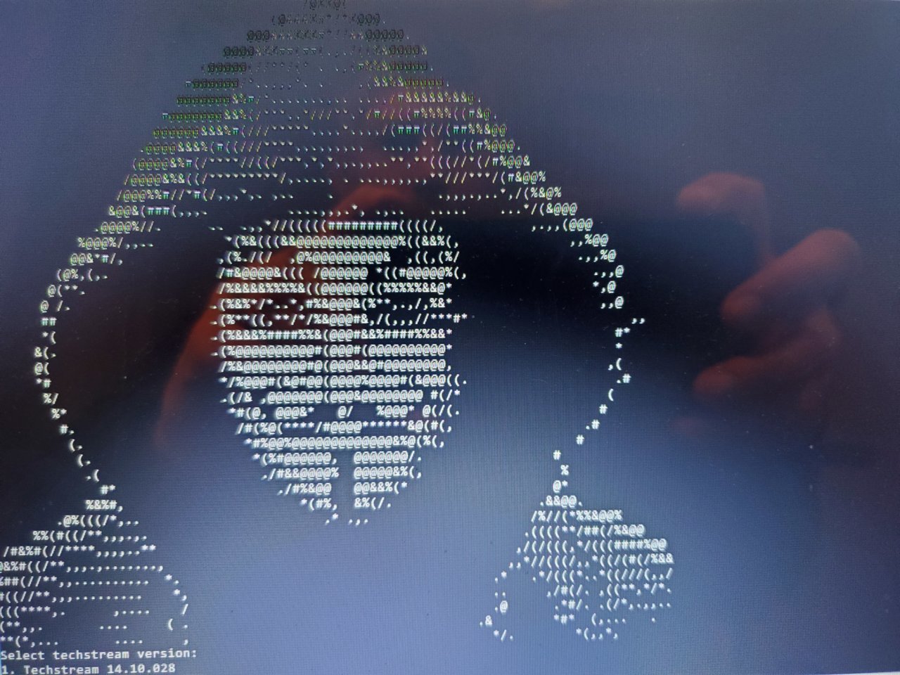

  7. Dec 2, 2020 at 8:59 PM
    #3707
    dilbert
    dilbert AI Member
    Mar 14, 2016
    #181276
    2,857
    PNW
    2019 DCLB TRD Off-Road
    Well that was way easier than I expected. I guess I'm all ready for when my cable gets delivered.
    Edit:. Thanks @Shellshock for the step by step guide, that's what made it so simple.
