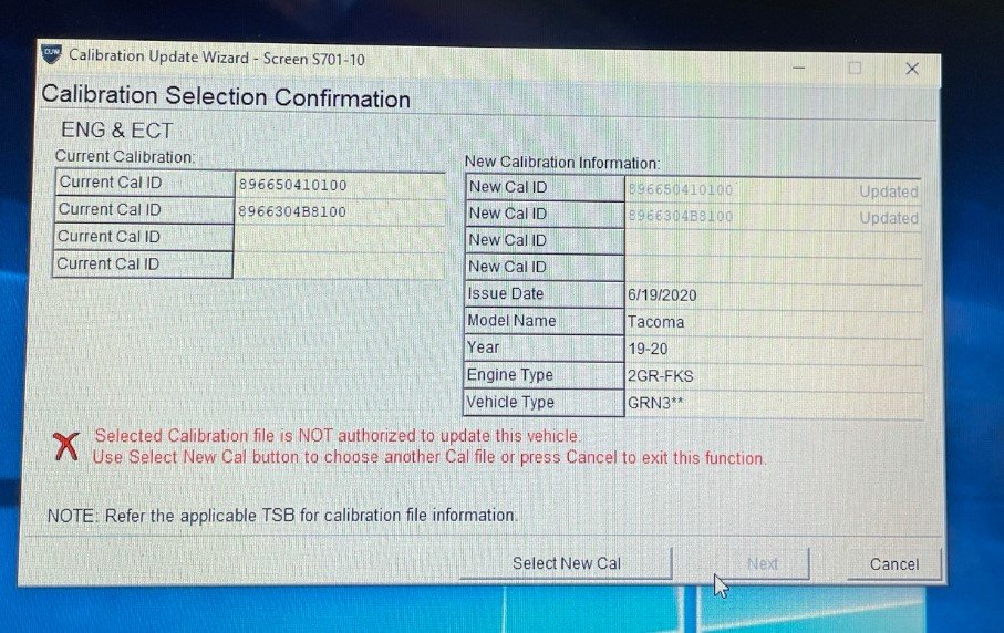

    i am all setup to due update i just dont get how i chose the corec cuw file for my truck (04a60)... readed the instructions thread 4-5 times but i just dont get this part... i know im just not seing something need a litle help.. for the rest great post and impecable instructions thumbs up!!

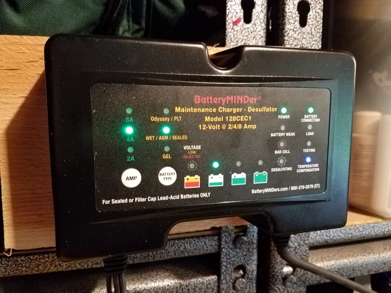

    Question for you:
    Did you have a battery charger hooked-up to your battery during this process?

    Bastek, ktbell444 and tonered[OP] like this.

    dilbert[QUOTED] likes this.

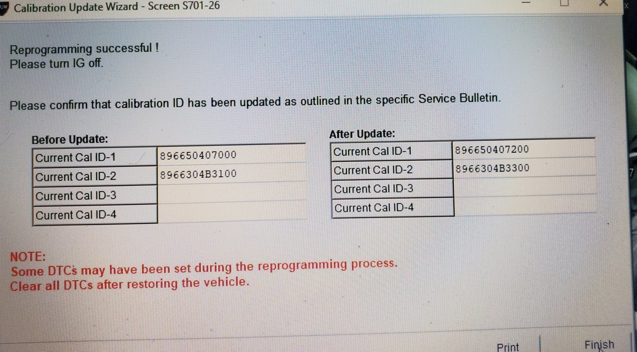

    thanks to ALL involved, for bringing this to the masses. just updated my ecu to 04b33, from 04b31, reset all dtc's and learning values, changed some settings for turn signal, and seat warnings. i was stressing over nothing. truck is idling now, will test drive later. thank you again! now bring on the 2.0 with maps for 04b33, or vf tunes for the same. Ski
