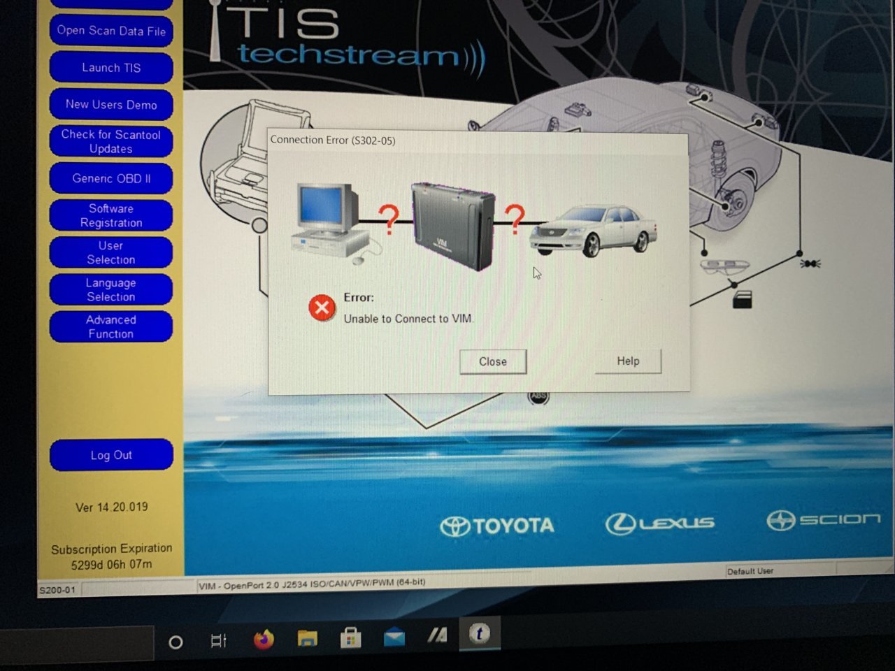

  9. Dec 15, 2020 at 3:30 PM
    #3789
    whitedlite
    whitedlite Well-Known Member
    Jul 14, 2016
    #192033
    9,308
    USA!
    3RD Gen TRD 4WD
    What is this?

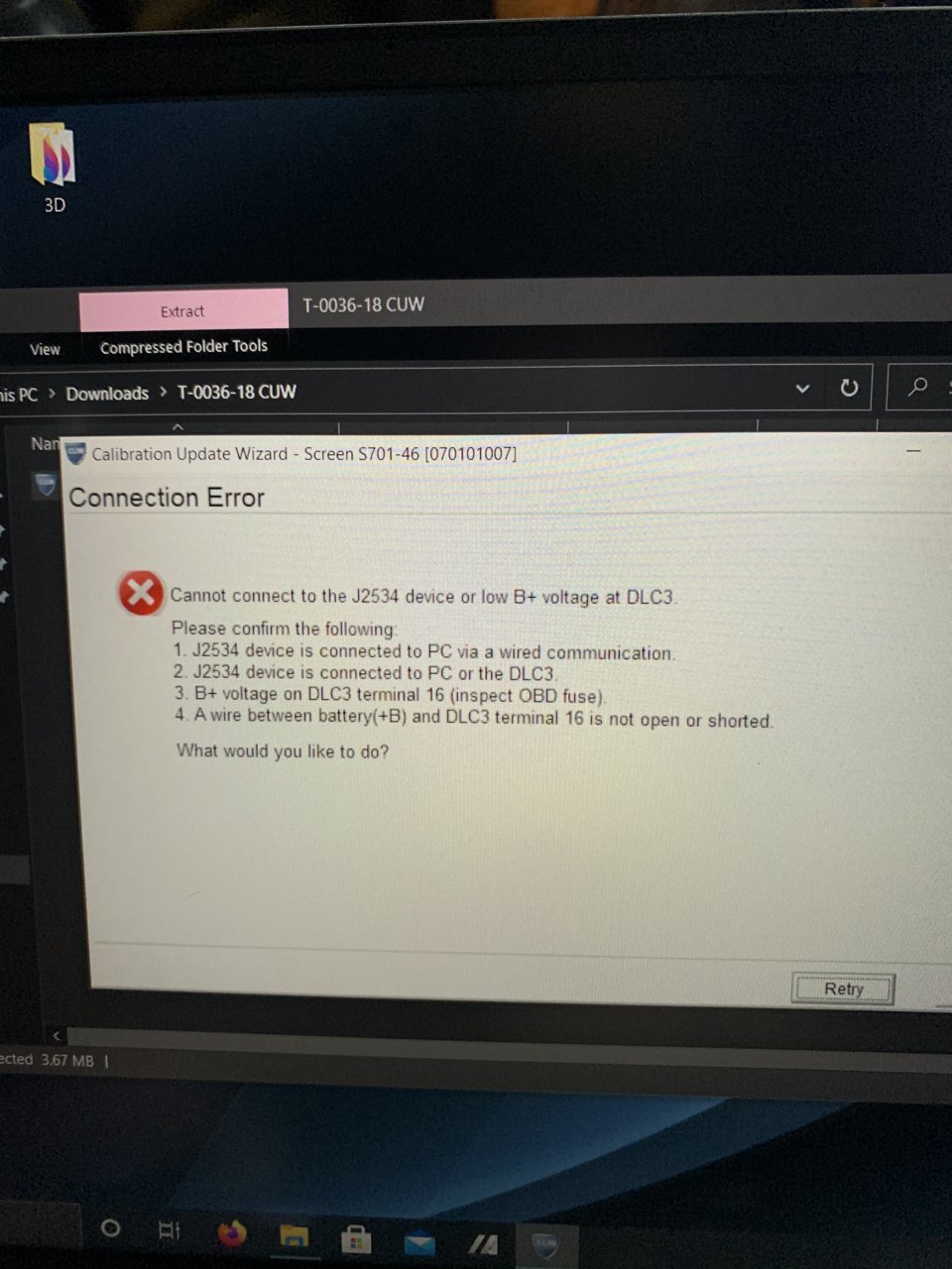

  10. Dec 15, 2020 at 3:31 PM
    #3790
    whitedlite
    Jul 14, 2016
    #192033
    9,308
    USA!
    3RD Gen TRD 4WD
    What is this
  11. Dec 15, 2020 at 3:58 PM
    #3791
    dilbert
    dilbert AI Member
    Mar 14, 2016
    #181276
    2,853
    PNW
    2019 DCLB TRD Off-Road
    Looks like it doesn't recognize your cable or low battery voltage.
    • Did you download the drivers for your cable?
    • Did you choose your cable from the menu?
    • Are you connected to a battery charger?
    tonered[OP] and MGMSangTaco like this.
  12. Dec 15, 2020 at 4:17 PM
    #3792
    Shellshock
    Nov 21, 2015
    #170338
    23,315
    Iowa
    ^this is the solution
    tonered[OP] and dilbert[QUOTED] like this.
  13. Dec 15, 2020 at 4:33 PM
    #3793
    whitedlite
    Jul 14, 2016
    #192033
    9,308
    USA!
    3RD Gen TRD 4WD
    Downloaded newest drivers in first page. I’m using OVtune cable and module. It worked on my truck. Could not connect to this truck though.
    weird thing about this driver update is there was an open port 2.0 option with x64
  14. Dec 15, 2020 at 6:42 PM
    #3794
    dilbert
    dilbert AI Member
    Mar 14, 2016
    #181276
    2,853
    PNW
    Hmmmm... Going to defer to the experts on this one.
    @Shellshock @tonered

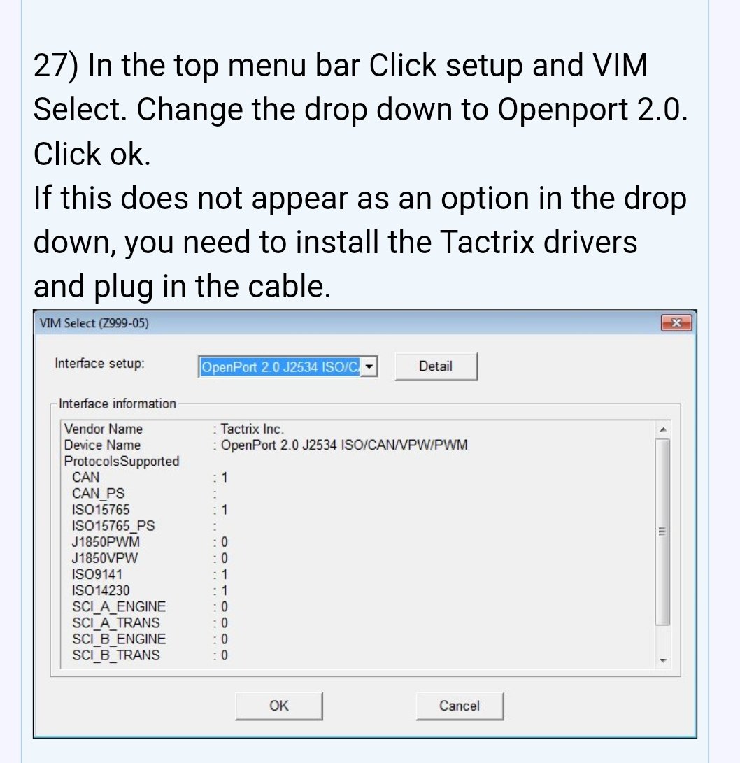

  15. Dec 15, 2020 at 6:59 PM
    #3795
    Shellshock
    Nov 21, 2015
    #170338
    23,315
    Iowa
    What truck are you trying to connect to?
    is it still working on your truck?
  16. Dec 15, 2020 at 7:03 PM
    #3796
    whitedlite
    Jul 14, 2016
    #192033
    9,308
    USA!
    3RD Gen TRD 4WD
    I'll try reconnecting to my truck.
    It's a 2018 SR5, I turned key to ignition on position when attempting.
  17. Dec 15, 2020 at 7:15 PM
    #3797
    tonered
    tonered [OP] bartheloni
    Sep 25, 2017
    #231055
    31,138
    tony
    Lynnwood, WA
    Be sure that you selected the Tactrix drivers in the Setup menu / VIM.
