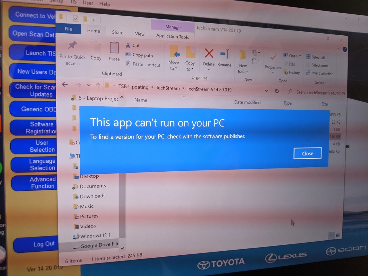

    I knew it was too easy to expect this to work in my environment. I can have the latest and greatest in computers, but when it comes to something like this it won't run on what I have. Anyone seen this popup after trying to run techstream-act.exe?

    Right click, run as administrator

    I had tried that out of the gate, same pop up

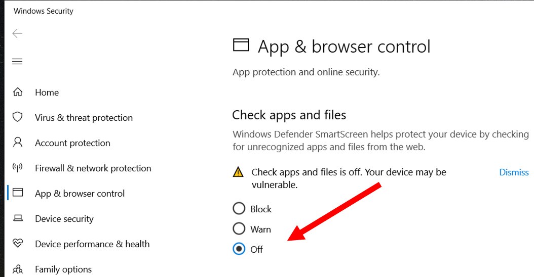

    Disable smart screen

    So did a right click to run in compatibility mode and chose to run as Windows 7...seems i'm in at this point...

    Seems I don't have Smartscreen following every google'd method of disabling it. It just doesn't exist on my machine, or, it's cloaked as something else. But I thought I got past the popup until, it popped up again.

    yep, that's all off, i have to chuckle at how many different security functions windows has. just moved back to windows from OSX late last year. i'm sure there's an obscure checkbox somewhere that needs to be unchecked or checked.
